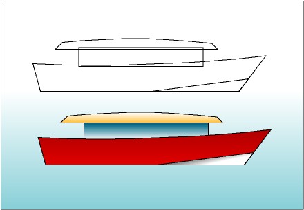

    Ok, I have been guilty of beating the vector graphic drum for Corel Draw. However I have now stubbed my toe on a really annoying shortcoming:
    Corel Draw allows color fills only for objects. Which is absolutely no issue for isolated objects. Very easy to combine the line segments into an object, and then fill. Adjacent areas are a whole other kettle of fish. As adjacent areas (objects) will share the same line segments in many cases. The only way to accomplish this sharing is to duplicate the line segment. Then assign the duplicate segment to the new object. Which is a royal PITA. It would be far easier if Corel Draw allowed you to fill any arbtrary area bound by line segments. Even when those line segments have NOT been organized into an object.
    But Corel is the only vector graphic program I have tried. Do any of the other vector programs out there allow you to fill an arbitrary area? Without descending into the object definition game?

    "Are you drawing single lines and then connecting them to get an object" - Yes, I start with unassociated lines that are bezier curves.
    Corel does also provide for planting shapes onto the drawing. Which are certainly trivial to fill. However mutating those into complex shapes, or making sides of adjoining shapes conform to each other, is not so easy. Thus I have been starting with lines, as in a sketch.
    Connecting such lines for a single object is not the problem. Getting two objects to share the same line seems impossible. Without duplicating that line for the second object.

    Yes, you can duplicate and cut in the lines, but most of the times you dont have to share a line, just put the objects on top of each other...

    Humm. Just let the object layer order take care of the boundary between objects instead of sharing lines. Does make sense Lars, good suggestion! Please excuse me now while I go beat myself up ...
