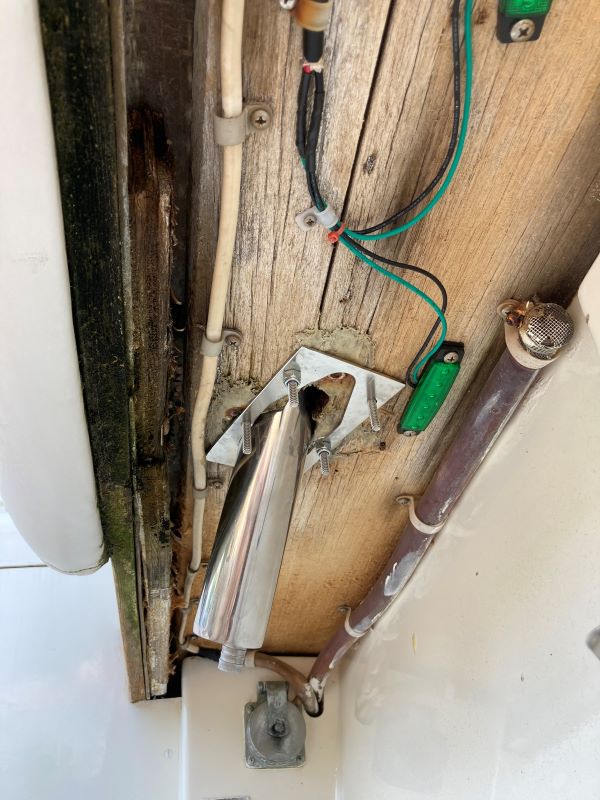

    Only wires under the cockpit comings are for the 12 VDC cockpit lights, unless they don't exit the plastic tube and stay in engine room.
    Quartz lights are on the hardtop (aft facing), and a 120VAC outlet box inside the helm console that now runs the Starlink. Engine room lights on ours are on the 12VDC sircuits.

    In the picture you posted, my boat has a duplex outlet mounted above the power inlet and the power inlet itself is lower on the bulkhead than yours.
    On my rig you can easily remove the inside panels,( they would be forward of your inlet, like blank plates, to gain access to the area behind the inlet) which you don't have because yours is a 43 or 42 and the cockpit is a little smaller, but maybe the deck outlet cable is in coaming or accessible from the engine area.
    I can sort of get to the inlet cable from my engine room but not easily.

    Mine has the phone inlet alongside the power inlet. It used to have two shore power inlets, they were removed and the current 120/240 50A inlet put in it's place. The external shore power goes to two separate (A & B) breakers on the corner post in the interior directly above the outside recepticle. Power runs to two (A & B) dual breakers in the main distribution panel on the back galley wall.
