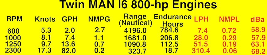

    I found this information on boat-test about the burn rate for a 65 with the 800 hps Man engines: 1.jpg
