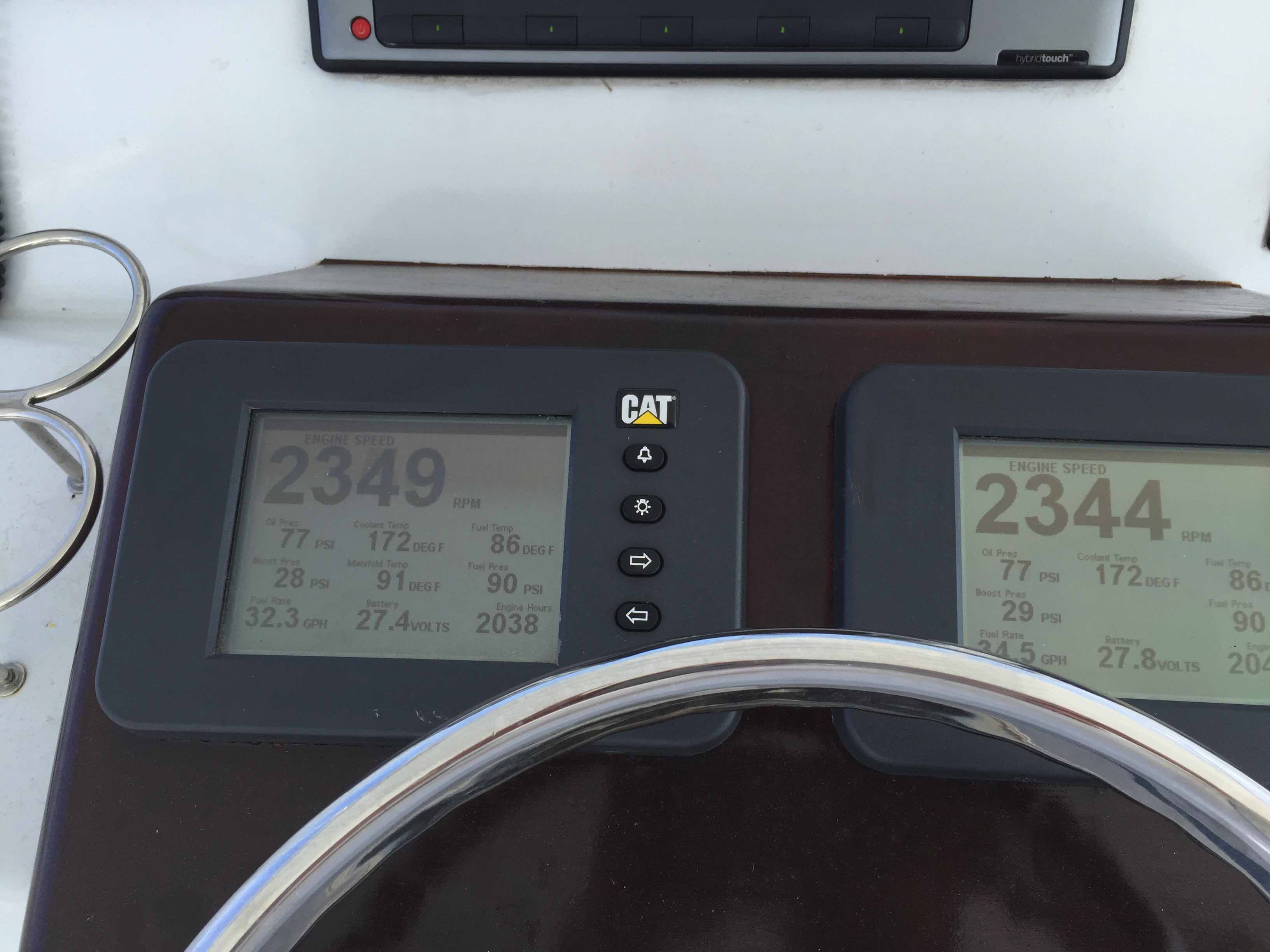

    3406E-800's on a 53 Convertible fresh out of the slings with a perfect bottom, perfect props, and very light on fuel as well as water. WOT sea trial...
  18. rtrafford
    rtrafford Senior Member
    Jul 13, 2019
    1,590
    Vero Beach
    Full of fuel and water she would turn at or just shy of 2325. Sharing the data for you to compare.

  20. mapism
    mapism Senior Member
    Aug 9, 2008
    2,116
    Sardinia
    Bad manifold temperature sensor on stbd engine, possibly?
