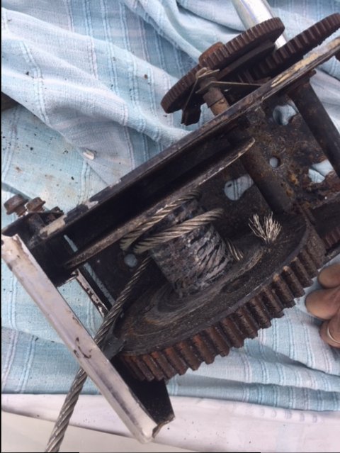

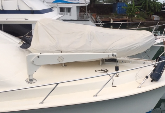

    I have a quick question about my UMT Econo davit. The winch motor seems to have burnt out. I am trying to figure out how to remove it for repair/ replacement. The issue is I do not have any manual or technical information for it, and I was unable to find it online. Does anybody have any experience with this type of winch ?

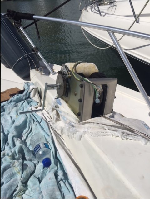

    Hi Rcraps. the last time I ran the winch, it was making noise and was smoking. I just about got the dingy onboard before the breaker tripped. I hope I did not cause too much damage. The fun part is getting winch out from the davit to repair it I hope

    Hi motoryacht lover. thanks for the response, I really appreciate it. I think your website link must have got deleted. Could you send it to me in a PM I believe we may have the same winch. I do know for sure that my winch is AC current. I could hear the generator bogging down when I was last using it. i am going to attempt to take the arm off today to access the motor. so fingers crossed

    Hi rcrapps, dont worry the system is made by UMT, I believe the econo part is with regards to the arm having to be raised and swung out manually. no electric function for that one. So a bit more difficult, but then again it is mechanically simlpler

    Thanks for all the help guys. I called UMT and with some measurements and details from my old unit, we were able to determine what model winch I had. The technician there was very helpful with emailing me the drawings to confirm that I was ordering the correct parts. Luckily I had friend from home making a trip to Ft Lauderdale and they were able to swing by UMT's office and pick up the winch and motor assembly for me. My old man and myself spent the better part of a Saturday morning removing the old winch and motor setup and reinstalling the new one. Everything works so far. just need to try it with the weight of the dingy now
