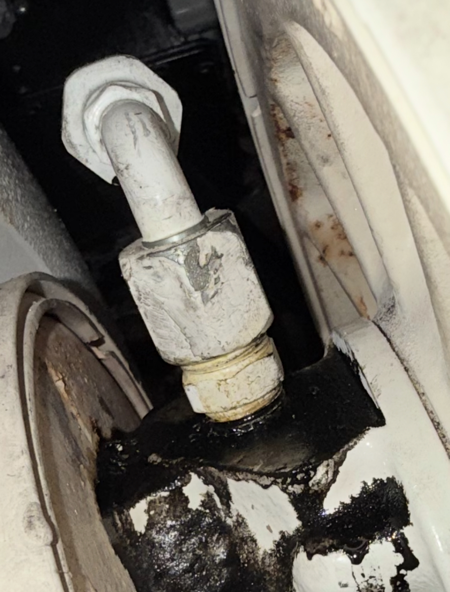

    There is an oil leak from the fitting on the turbo that the oil hose mounts onto. I was able to tighten the fitting a 1/4 turn which reduced the leak a little. I’m thinking of unscrewing the oil hose. Would a claw / crowfoot socket be the tool to use between the two turbo housings?
    If I can get the oil hose off, and get a socket on the fitting. Should I just tighten the fitting down to the turbo body or remove, clean the threads and use pipe sealant on it?

    You should be able to get to that with an open end wrench, might have to flip it each turn. I would inspect that piece very carefully as they generally don't just start leaking like that unless that pipe cracks.

    Skippy J is correct.
    I would have a new fitting to install when you jump on this.
    Trash the old one.
    Also, do not over tighten the new nipple. Let the fresh brass do its job.

    I may be seeing this incorrectly, but it looks to me like the oil would have to be running up hill if it's the oil hose. Am I seeing it wrong or is the turbo housing cracked?

    So a new nipple with no pipe sealant. As always I greatly appreciate your advice

    The whole turbo assembly was dismantled to repair a crack on the water jacketed exhaust manifold. The actual repair was quick and easy by a good welder. The removal and reinstall by MTU tech no so much. Maybe it was damaged or loosened during that process.

    it seems to be leaking where the mounting nipple meets the turbo block. I think it’s leaking at the base of the nipple. I cleaned it up and will look again after running for a few hours. The picture is showing the top of the turbo block

    That fitting looks like a male pipe-jic adaptor and I would use a good teflon based sealant on the male pipe end that threads into the turbo housing. Once you break loose the jic nut you should be able to unscrew it by hand, then remove the adapter with a deep well socket.

    One micro flake of teflon till destroy the front oil face in the turbo hub.
    Original nipples like this that have been installed for many years/hours just don't start leaking.
    It's a cheap plumbing part, replace it and start over again.
    It's on top of the turbo hub, easy to watch after assembly.

    Be careful what you use to install the NPT end with. There are different types of Teflon tape, and the common light-weight one is a thread lubricant, while the heavier ones are thread sealants. I've re sealed many Teflon tape connections on fuel and lubrication systems, and prefer hardening Permatex gasket sealer.

    For those in Rio-Linda,, Do not use teflon.
    The fresh brass will do a great job.
    If you must use pipe dope, Use LocTite 515 one or two threads from the NPT tip.
