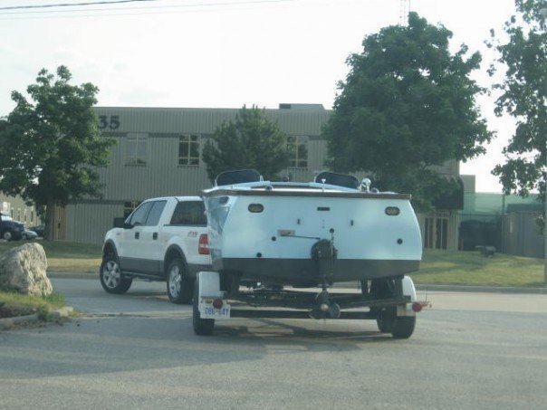

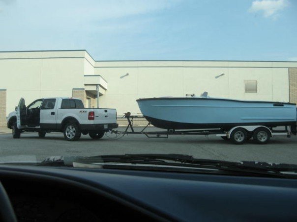

    I added some pictures here...hopefully it works, I'll try and get a closeup photo of the transom. As for the hull material, its fiberglass and the length is 21FT.

    Nice looking little boat you got there. I am thinking if it was my boat I would be looking into turning in into an inboard possiblely utilising a v-drive. And puting a nice swim platform on the transom.

    ERTW, that's a great-looking boat. The break in the sheer and the barrel-back transom are retro-cool, IMO.
    Makes one wonder why Lars doesn't do a modern variation on that theme.

    Thanks Loren, that was exactly what I first thought when I saw her hull lines! When I'm down at the marina docked, alot of people walk up thinking its new meant to look retro, because unless you take a close look at the hull or the outdrive, everything else is new from the deck up!
