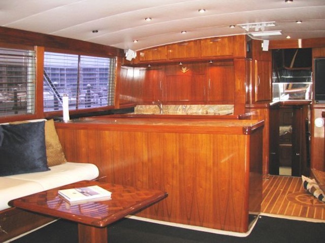

    Here is a photo of the salon when I purchased the boat.

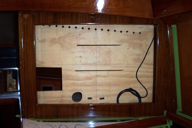

    Here is new custom surround for the television in the salon ... notice the dark black grain in the wood.

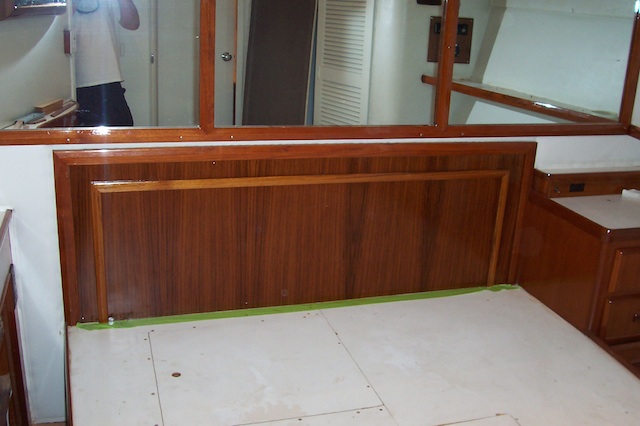

    And the new master headboard. The trim is the correct color but the headboard has the black grain and it's not the look I want.
    The wrap for the TV in the salon and the headboard are both done in Teak plywood and I'm inclined to believe this is the problem. But ... my carpenter says the teak plywood is no different from the teak plywood used elsewhere in the salon which looks fine.
    The same Schooners Varnish is used on all the teak.
    My carpenter is going to take several samples of this same teak plywood and apply different varnish, epoxy etc finishes to see if we can come up with something I like but I tend to believe it's the wood itself.
    To add to the frustration, my carpenter says that the dark grain will lighten up over time and will be the SAME as the rest of the teak on the boat! Hard for me to believe.

    It's true that with enough exposure to natural light, over time the new teak will lighten up. And teak veneer on plywood is no different than solid teak as far as the wood surface. But the quality of most of the teak that is available today is not as good as what was available 25 years ago. Today there is more dark stain, and more sap wood. In other words, there is more color variation in today's teak. A result of more pressure on foresting logs and cuttings that would not have made the grade in decades past. Some would consider the variation in color and grain a part of the natural organic beauty of wood.

    Yes indeed. In doing yacht refit, one must at some point, embrace the color variation of natural materials.
    We have tried to match teak interior veneers where the color varied from port to starboard in the same saloon due to the sun exposure. The color will change with age, no doubt.
    On that headboard, by the time you get your mattress, pillows, bedspread and shams on there- you won't see the headboard anyway. In the other applications, consider a variation/contrast in the wood or grain. Perhaps by introducing a burl accent.
    There are also some other woods with a similar grain to teak that could be used and then stained to match existing. Take a look at "Anigre".
    The work in your photos looks good. Perhaps give it some time to season and see how it looks.

    Everything in the photos is Schooners Varnish ... I like the look of the Salon that was done years ago using Schooners Varnish but I'm less happy with the TV surround and the headboard that was just done with The same product (Schooners. Varnish)
