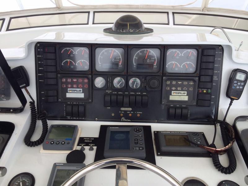

    They are 3412 PEEC engines. 1350hp first gen electronic and I dont see a low rpm option. Which would be awesome if it could be added ( or discovered)

    Without the manuals and schematic you're not going to find it or even know if it's there. If there is a Cat marine shop close, go to them with serial numbers. Service managers (writers) usually can look some things up and help with a Go / No-Go plan.

    On your engines, it would either be on the plate that you access the controls with. Or, a seperate switch, usually a rocker switch that you can press and the rpms will go down when the switch is pressed. It would be a good question to ask the selling broker/owner. What RPM do they currently idle at?

    No rockerswitch but boat is a repower so some stuff is funky. It idles at 600rpm.
    I does sound like the trolling valve will be good for no wake zones. We haven't figured out how to work them. There is a start, stop, and troll budget. Is this usual? What's the sequence.

    Those are the the Cat panels I remember. With the schematic, an extra switch could be added to your existing harness. Again, you need the prints and manuals.
