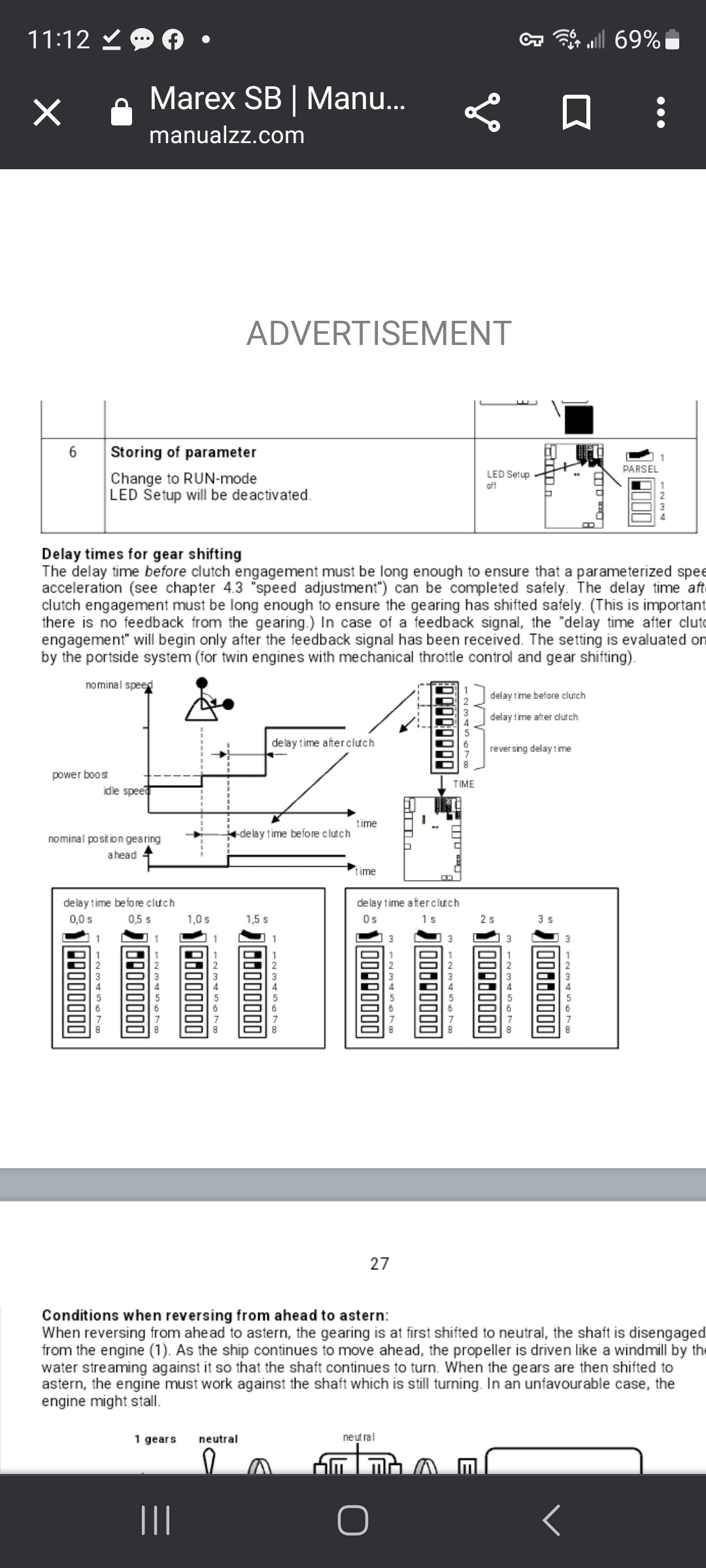

  13. mapism
    mapism Senior Member
    Aug 9, 2008
    2,297
    Sardinia
    With MAN common rail engines like yours, the typical throttles pairing is with the so-called Mini Marex levers, the black ones with the command button on the left and the synchro/throlling button on the right.
    If that's what you've got, here's a couple of comments.
    First, if that trolling function is what you were referring to in your OP, it's actually a bit misleading terminology, because what that button does is electronically reduce the engines idle speed, regardless of whether your gearboxes are actually equipped with trolling valves or not (my guess is they are not, BTW).
    Second, the delay quite likely doesn't depend on whatever gearboxes you've got, but rather on the electronic controls, and if so it should be adjustable.
    Also because in some conditions, even 2 seconds wouldn't be enough to avoid destroying the gearboxes: just think of the crash/panic test (which should be part of the initial engines commissioning), where you move the levers as fast as you can from WOT forward to WOT reverse, in one hit.
    If forward would be disengaged with "only" a 2 seconds delay, the engine would still be well above idle, and also the following 2 secs before engaging reverse wouldn't be enough to avoid damages.
    But the controls should take care of all that, allowing engage/disengage not only depending on a fixed delay but also on the actual engine RPM.
    Anyway, a 2 seconds delay upon any engage/disengage with engine already at idle is something I've seen on several boats, and while I appreciate it can be a bit annoying, it could well be the original setting the boat came with.
    But as I said, your MAN engineer should be able to reduce it for you, if you wish.
    He will probably advise against it, and possibly ask you to sign a waiver of some kind, but...
    ...You pays your money and takes your choice! :)
  14. johnnry
    johnnry Member
    Jan 21, 2017
    77
    Babylon ny
    yes exactly mapism,, is the Bosch rexroth controls,however does have the slip clutch electric trolling valve..I have attached adjustment procedures from the o&m..On survey ,Man tech advised NOT to lower rpm...as boat is new to me ,not ready to futz with this dipswitch Screenshot_20230701_111252_Chrome.jpg yet..good news about Med is there's no running tides ..Ill try the troll feature first..
