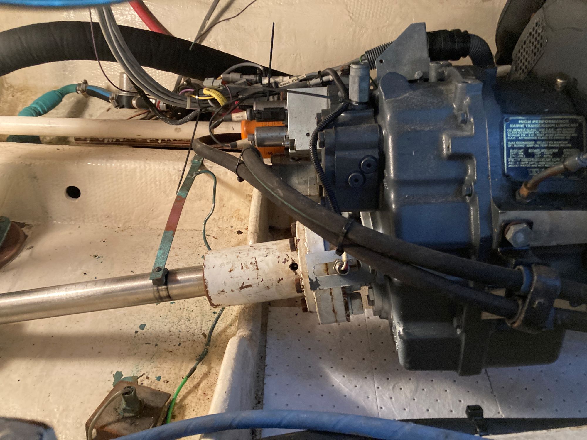

    I was wrong. They are down angle transmissions. I hadn't looked at them that close enough. Was checking them today and got a good view.

    Never noticed it before. Or the broken bonding wire I need to fix (it wasn't broken in earlier photos). There is also an unused P80 shoot-through transducer up by the genset.

    What is the sensor with white and red wires pointing to the shaft flange meant for?

    I believe that is a speed sensor for the output shaft/coupling.
  6. Capt Ralph
    14,272
    Greg has the ability to slow his boat down more with trolling valves.
    That sensor offers the shaft speed.
    Pending the controller (human or computer), the amount of deliberate forward clutch slip can be controlled to a fine value or ratio.

    The transmissions have two trolling modes.
    1) throttle remains at idle, speed controlled only by amount of slip
    2) speed controlled by slip up to full engagement, then feeds in limited throttle.
    Mode 2 can be run with or without electronic engine sync engaged

    For some reason I only just noticed your answer.
    Interesting, do you possibly know which type of sensor is used for that?
    I've always seen shafts and/or pulleys rotation speed measured with the laser gun.
  12. Capt Ralph
    14,272
    Usually a magnetic pick up.
    Years ago I used to glue magnets to the inside of harmonic balancers and drilled and inserted a magnet into coupler bolts and mounted a cheap mag pick up near those magnets for a tach pick up signal.
    Cat was using just the teeth on the flywheel ring gear for their tach signal.
    In the picture above, there may be a metal disk under one (or more) of the flange bolts holding a magnet or iron ingot.

    There is a speed sensor at both the input and the output. They also have their own dedicated ECU's.
