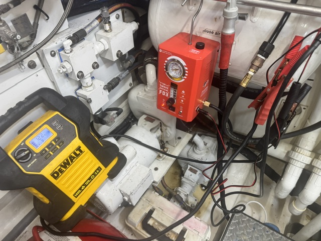

    Trying to find a way to find a leak in our compressed air system. Air compressor runs fine and builds pressure in the tank but once the tank outlet valve is open, pressure drops and never builds again. Tried to listen for air leaks, sprayed soapy water on visible connections. No luck.
    it s long hose run from the compressor in the ER to the horn solenoid valve in the skylounge, including a second accumulator tank and a drain pipe going back down to the ER…
    i considered using pressurized water but draining it all afterward may be be tough and the leak could cause water damage
    Has anyone used an automotive smoke generator ? Provides up to 7 PSI or pressure.

    The problem is that some fittings are very hard reach as the hose going to the horn runs behind the chillers in the ER then behind salon cabinetry then in the space behind on the side of the skyloung3 where the second accumulator tank is. And in the ER the hose runs behind a bunch of panels … major pita.
    I ordered a smoke generator that builds 15 psi of pressure… under $100.
