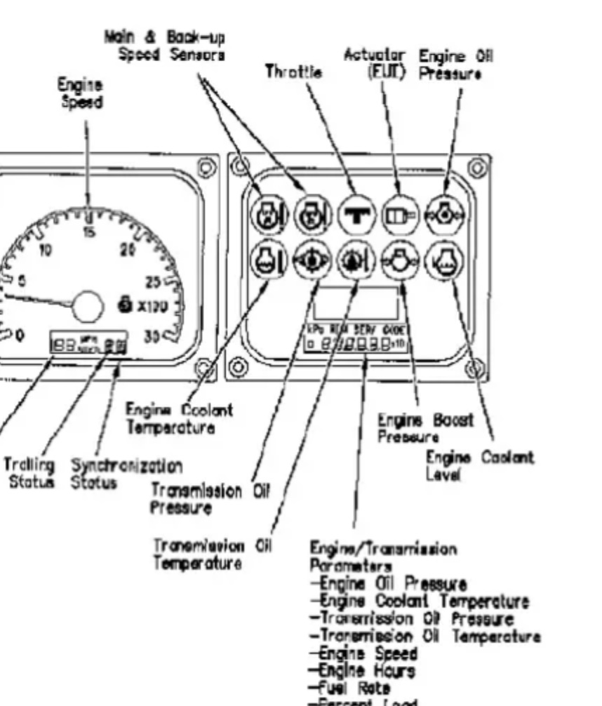

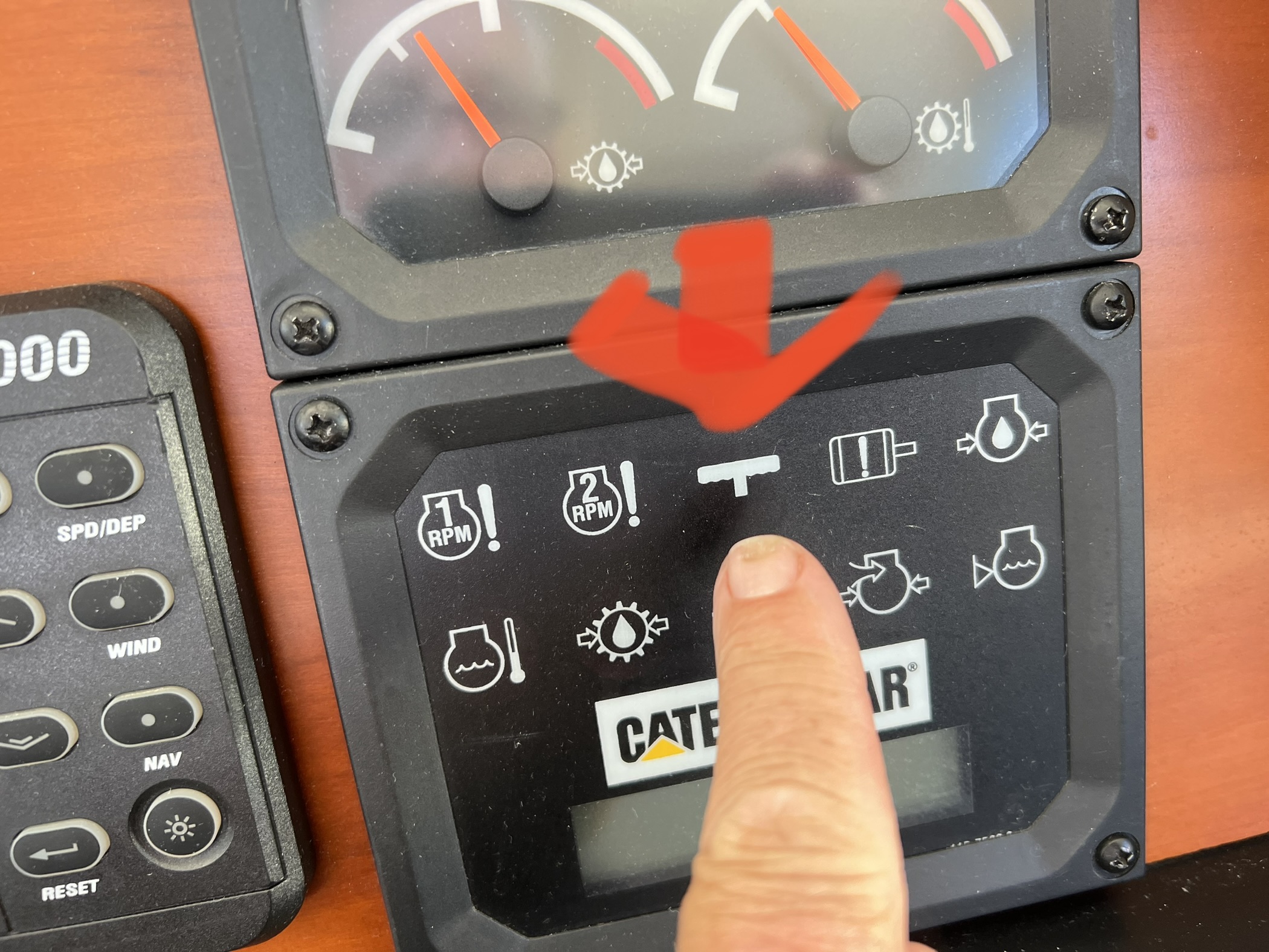

    We replaced all three Kobelt throttle controls including the main board. Started the engines and everything seemed ok except the we got a red light on the alarm code box on the “T” like light depicted in the picture. We can’t find any reference in the manuals as to what the T alarm code means. After shutting the engines off and later attempting to restart, the engines are dead. Batteries are fine. Any ideas what that code means or suggestions on what to do?

    The T alarm icon means throttle. That may not help you much, but that’s what it means.

    That is helpful. Thank you.
