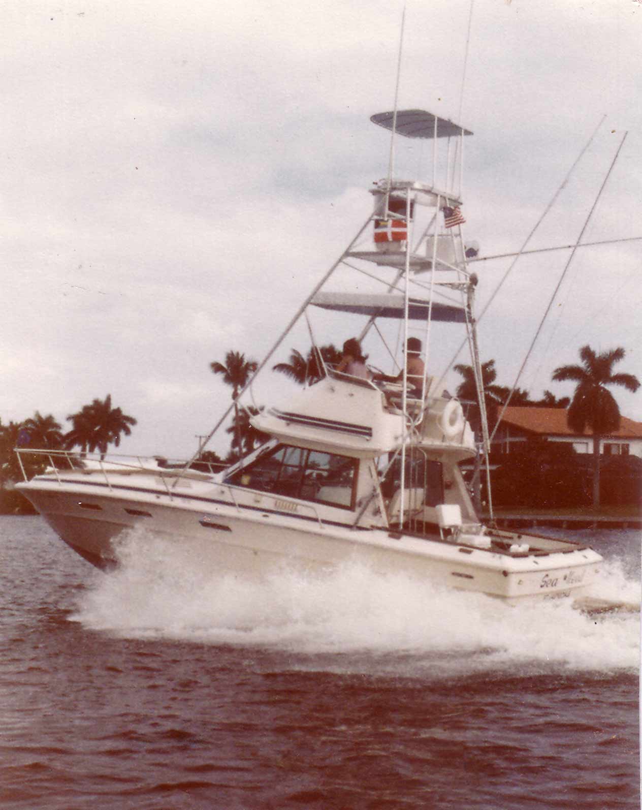

    Ok it was a LONG time ago when I took up fishing, sold the go fast boat and bought a 30 ft. Sea Ray bridge model. Buddy had purchased a 28 Bertram around the same time. Sea Ray was more stable. Bertram was far superior in a head sea. The Bertram had a feel of solidness the Sea Ray was always lacking. Sold it after 5 years and never considered another of the brand but hey that's just me and like I said a long time ago.
