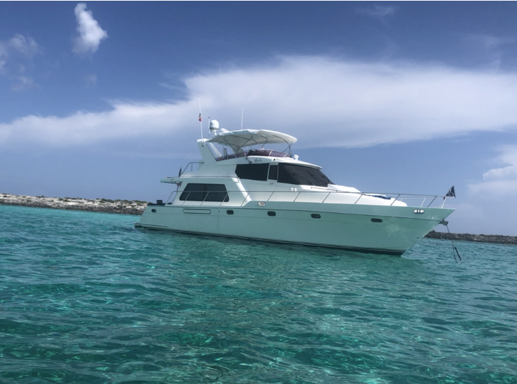

    There is a Pama54 LX named Adesso for sale in Ft Myers you should look at that is in your zone/range. Not sure of the rules if I can link it here, but you can Google it.
    I have the same model/year and really have been impressed with my fit/finish, performance and layout. I’ve put over 300hrs on mine since 2018 and have really enjoyed it; multiple ICW cruises, taken over to Bimini, West End, Abacos, Chub, Keys, Fl mini loop across Okochobee... plan to do the loop with mine.
    Its a relatively unknown brand; I have hull 11 with Volvo D-9s that can get to 25kts, but cruise great at 20kts
