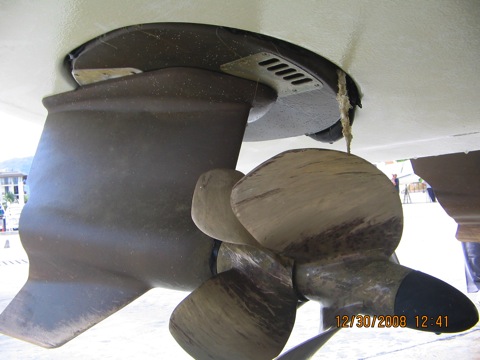

    These pictures and descriptions were taken from the Thailand Boating Website.

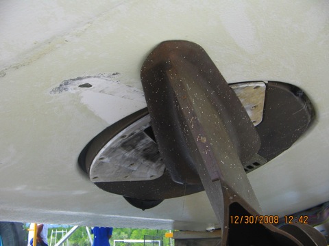

    Note the packing hanging from the front edge of the mounting plate. This was to stop the water flooding into the engine room. The rubber gaskets which are supposed to do the job of flood prevention, obviously do not. The drives are supposed to shear off under high impact and the gaskets are supposed to seal the water flow off. They don’t!
    The high speed impact pushed the rear end of the drive unit into the hull of the boat as can be seen from the white mark. Fortunately the hull of this brand new (less than 10 hours on the log) Sunseeker Portofino 47 was strong enough to take the impact without any damage. The surveyor checked the hull with Ultrasound to verify this. Luckily the impact also failed to move the engines on their mountings. Note the “cabbage head” props.

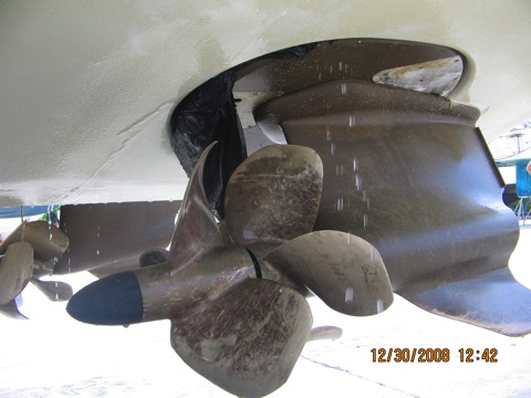

    This particular accident happened in the early evening but by next afternoon the engines had been removed for repairs. The whole engine room was flooded with both engines under water and had it not been for some quick thinking by the captain and crew, considerably more damage could have occurred if the engines had not been shut down so swiftly.
    Conclusions.
    The damage from this accident will require the engine electronics and engine room wiring and battery chargers, to be replaced. The Kohler Generator will also have to be replaced completely as everything was under water. Luckily this boat is built with a watertight compartment enclosing the engines and drives. If the boat had not had this feature then it would have sunk before help could have arrived. This leads me to believe that a shaft and strut system would not have sustained the same vessel threatening damage and the repair bill would be considerably less. The other thing to consider is the possibility of the loss of life under different circumstances.

    That's bad, and highlights a vulnerability that everyone suspected and feared, but were assured wasn't the case. Undoubtedly there is a stress point where the drives are designed to sheer off at. Below that they should stay in place and take the damage like any other drive system. There should not be an in-between point. Those pics will put a crimp in IPS & Zeus sales.

    I disagree with this. These drives have been run aground hard, at the very least... at an on-plane speed. The damage to a conventional shaft/strut/prop/rudder system would have been equally severe, and just as costly.
    One of the programs I headed up some years ago required a craft to be beached at a high rate of speed, with no operational damage. Because we were using pumps, this wasn't a problem. Sand intrusion into deployable systems was the real culprit. I became intimately familiar with the ensuing damage on conventional systems.

    I agree also +2. However, I don't think this system really shouldn't have allowed the engine room to flood due to that kind of impact. It should have been built strong enough to survive that without massive water intrusion. The bottom skegs didn't even break off of the drives and it looks like it hit a softer/medium bottom from the pictures and not rock. I don't think the damage would be any less severe with conventional drives, but I highly doubt that conventional drives would allow enough water to come in to completely flood the engine room with this type of impact.

    Since we don´t have the whole story (yet), we can only guess. My guess is that if the boat stopped when it hit the sea floor, it may have been leaning on the drives, waggling and breaking up enough to start leaking, without sinking as it was shallow. Then pumped and towed to shore.
    Or this is the situation where it is impossible to judge at what impact the drives should come off, two knots more might have been the difference, or if the angle of the sea floor should have been steeper as it now seems to lift more than push the drives at impact.

    Still shouldn't happen.:( This is exactly what people feared with pods, i.e. that they would open the hole on impact. To me this means back to the drawing boards for IPS & Zeus.

    Really there is only one preferred system in Asian waters and that is the tried and true shaft and strut. Why? Like everything else which works it is simple and easy and repairs can be done at any local Thai shipyard.. Asian waters carry a huge litter burden which often results in prop strikes and reverse facing props are slightly protected by the shaft carrying strut, the angle away from the hull of the boat and the sturdiness of the prop blade itself. The same cannot be said for the latest IPS system from Volvo which faces the props directly into the water stream which means that the first encounter a piece of flotsam has with your boat, is with an extremely delicate pair of counter rotating props spinning at high speed, just below the hull pressure wave. The first two boats delivered to Phuket with this system attached, suffered the same problem of propellor strike resulting in the replacement of a pair of counter rotating props on both boats on their delivery voyages.
    They might have driven over something below the surface and the impact slight and just bent the props a bit and moved the drives without knocking then off.
    The fact that they say it happened to the first two boats makes me think it is more of a co incidence that one would normally see in such a small control group. I wonder if we will ever find out what actually happened.

    I'll take shafts & struts over IPS any day after seeing this. Although I've seen struts ripped from the hull after grounding. Either system, stay away from shallow water.

    I don't see the props being mangled as that big of a concern. That would have been the result no matter what drive system they had. The fact that the pod didn't either stay put or break off and seal itself is a major concern.

    It would appear she was making a hard turn to port when grounded. The IPS signature turning heel would put that drive into the bottom first, thus bending the skeg to port as in the second image and likely throwing her over to the opposite heel while still in a port turn. The steering may have survived the hit to be in any position when they were shut down.
    Perhaps more testing is needed for lateral impact. Or maybe, and even more likely, an improved torque testing procedure for Sunseeeker's drive assembly sandwich is in order. The system is designed to snap off if the union top-to-bottom is sound and to spec. Thus blanket statements of "back to the drawing board" are born of a Press mentality, and maybe of a personal fixation and drive preference.
    Like it or not, this drive system is real, has significant advantages, and is changing the way people part water.

    Actually, if you check my posts on the pod threads you'll see that I have been a proponent of pod systems for a very long time. In fact I've promoted and sold them on Chris Craft (one of the 1st boats to use them). However this is intolerable. If it breaks away from the hull it has to seal. Period. Until then it is back to the drawing boards.
