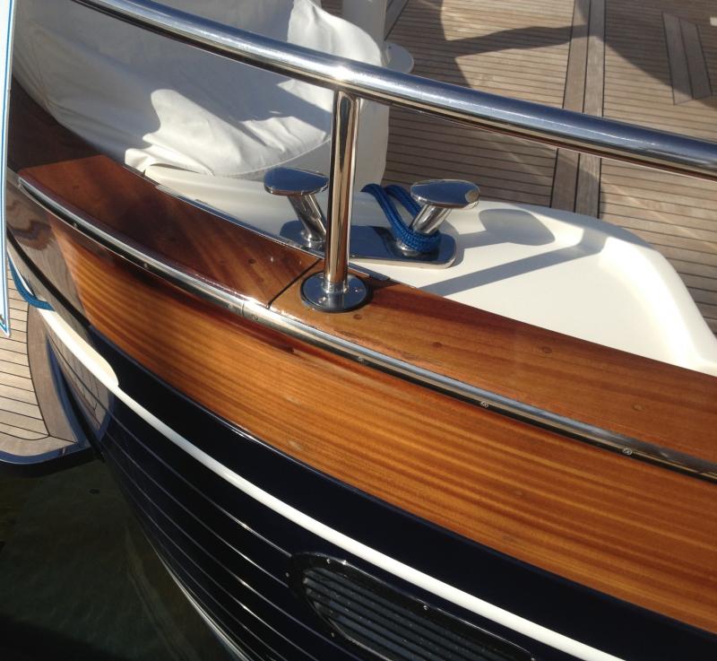

    Got to wonder what the designers at Apremare were thinking on this one....
    When you are tied to a dock that s lower than the cleats, you have to run the line on the cap rail which has a small rub strip but not enough to protect the wood. So this guy runs the lines down in the cockpit and out thru the deck drain, with the line rubbing on at least 3 fiberglass corners in the process...
    Nice design!
    And note how the wood is already stained with water intrusion... The boat has many such dark spots, I guess they didn't think about soaking the back in epoxy before installing I wonder what the broker tells prospective buyers :)

  4. NYCAP123
    11,208
    Those are nice looking boats, well finished and that's a nice cleat. Of course those rounded sterns can prevent crossing the stern spring. But someone really blew it there. A chock or hause hole not being cut in behind that cleat is is a major desighn flaw. The owner is doing himself no favors either. When a good strain in put on that line he'll be buying fiberglass.
  5. Pascal
    8,546
    I can't say that a boat with poorly protected wood which is staining from behind is well finished.

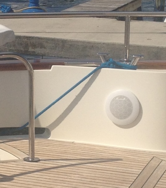

  6. Pascal
    8,546
    Here is another pic of how the lines have to be routed

  7. NYCAP123
    11,208
    My question is whether he'll be paying for a fiberglass repair before or after his lines part and the boat slides into his neighbor's boat. How could he even think that's a good idea?

  11. NYCAP123
    11,208
    I think someone played a game on this owner. I just looked over about a dozen and a half pics of various models. Almost all have the cleat atop the bulwark, and one I saw had a chock. What model is this?
    As for putting that cleat on the floor, with the corved transom seat on most of these I think it'd make a real good place to stub your foot.
