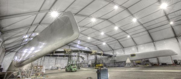

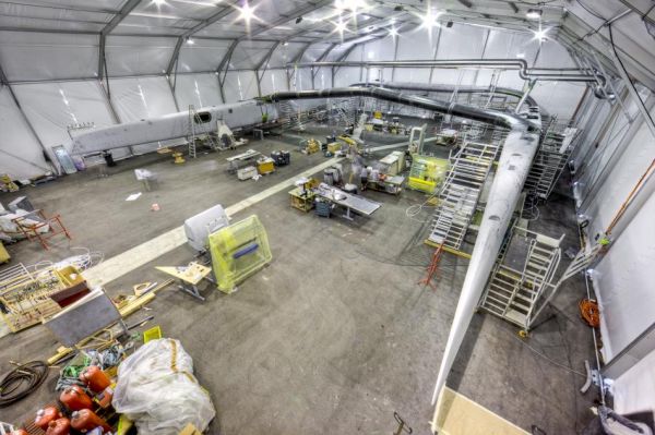

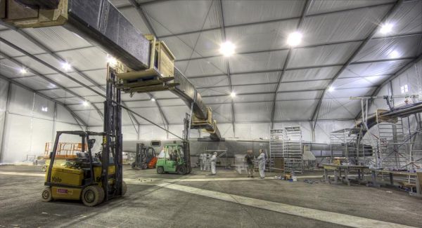

    ...and a few photos in the tent
    WOW :eek: , imagine the loads at those connection points between hulls and crossbeams...even without the huge rigging loads that will be applied!!

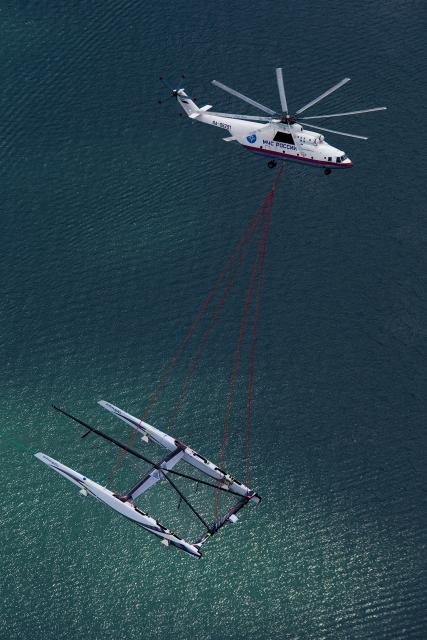

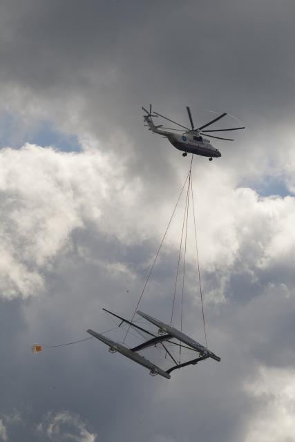

    I believe it was quoted that they were bringing in a big Russian helo that can do the job...longer distance and greater altitude

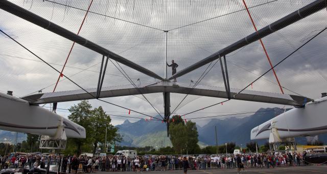

    Structure to support the Loads
    Interesting photo of 'wired' support 'structure'

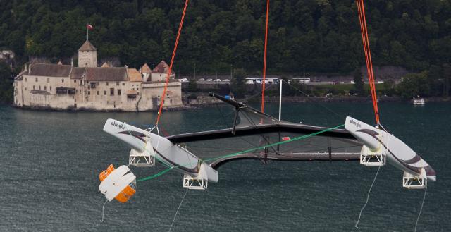

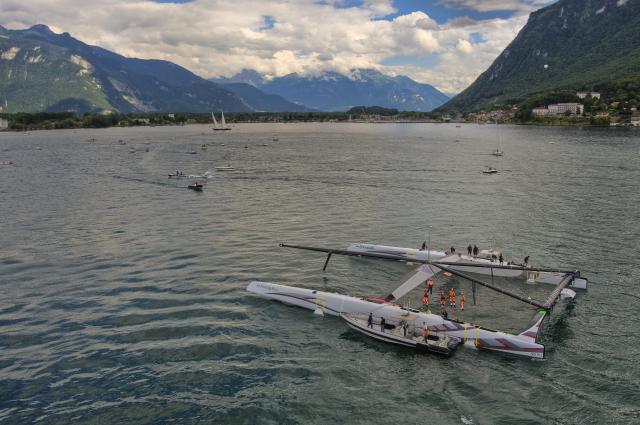

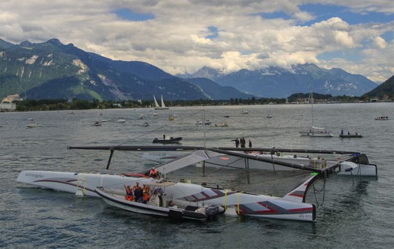

    Well here is the portion of the lake trip:
    ...more HERE

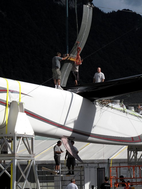

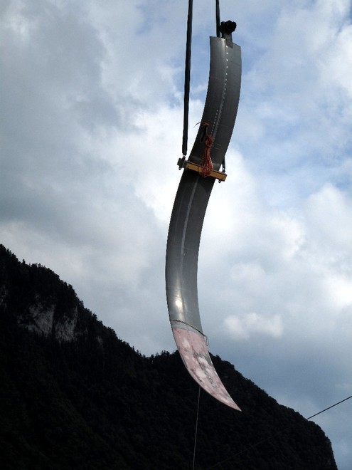

    Weird Daggerboards, Alinghi`s S-shaped Foils
    They have a strange look:
    http://www.sail-world.com/europe/Americas-Cup-Spycam---latest-images---Fitting-the-Boards/58725
    But how do they work ?
    This foil in the leeward hull can fulfill two tasks: horizontal/vertical lift or lateral lift.
    In "normal" position the foil is a common bananafoil for generating vertical
    lift like those of BMW Oracle. In this mode the upper part of the foil (that one
    going in the other direction) is above the deck.
    The secret ,or call it trick, is that the daggerboard-case is hinged to the hull`s bottom and goes NOT to deck level. Where the case is hinged ,one can see a rectangular area, similiar to those of canting keels.
    Pushing now the foil further down , means that the daggerboard- foilcase angles it`s top towards windward, angling the bananafoil more vertical for generating more lateral lift.
    The upper part of the foil never enters the daggerboard-case, you can see it on the red uphaul/downhaul rope on the pic. The upper part is guided by a slot in the deck.
    A very clever invention I think.

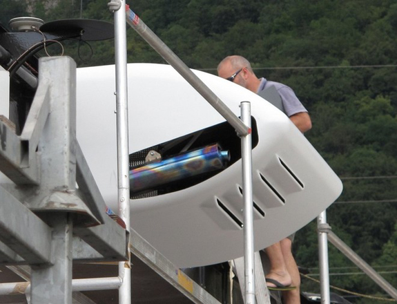

    Note the engine compartment off the rear crossbeam of Alinghi 5. Photo by Stefano Gattini/Alinghi.
