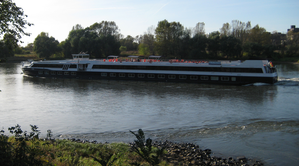

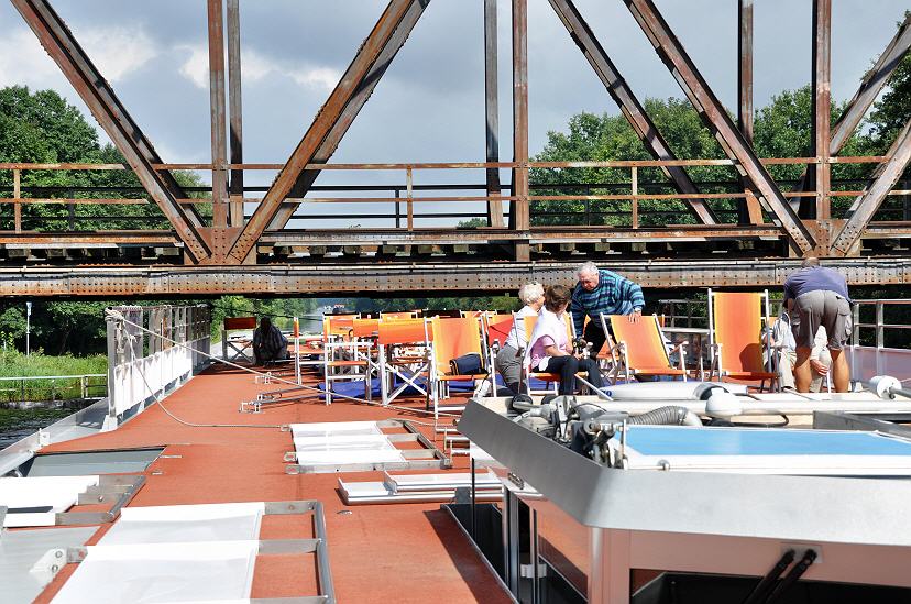

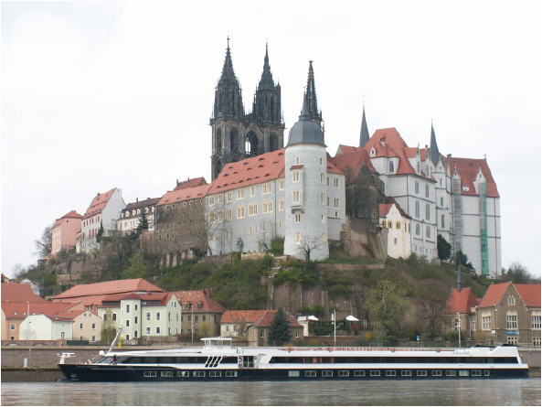

    My boat is a copy of an European (inland waterway) river cruise ship. Externally it looks like a cruise ship with fully retractable wheelhouse and lay down railing and large sun deck but internally it is designed as a yacht. Owner suite plus 5 guest suites on the main deck and a crew of ten in single cabins on the lower deck. It fits into the Europe Class of inland waterway ships. 280 ft hull length, 31.3 ft beam, variable draft with water ballast system, that can provide 5 ft minimum draft or 13 ft airdraft but obviously not at the same time. Very maneuverable with diesel-electric propulsion onto 4 x electric Schottel twin propeller azimuth drives and a Schottel pumpjet bow thruster. The boat is EU flagged and registered as a private passenger vessel (not a yacht!) but only cleared for inland waterways and rivers and protected coastal waters. It has a range of app. 2.000 NM and cruises at 12 Kts.
    Below pictures of the type of river cruise ship, the design was taken from:
    The only real external differences with my boat are on the lower deck with less but flush and non openable windows, as the windows on the lower deck are submerged, when going on ballast for lower airdraft and it has of course a teak deck on the sun deck.
    I would leave the boat for example in Canada during winter but only in a shed or on the hard due to ice and snow. And I do not believe, the certification would allow me to go to the Bahamas. I am sure, Rodger could be helpfull with that.
    Do not mistake this boat as a river megayacht. The black steel part is not expensive, as this boat is like a river cargo vessel, a square steel box (including the superstructure). Due to the pretty rough boating in the locks, the boat is not faired and the hull is painted to commercial standards. The expensive part is only the interior. And it has internal spaces for two onroad tenders (2 VW Busses), which can be launched by an long reaching and powerfull onboard hydraulic deck crane. It has pretty long telescopic passerelles on both sides to embarg and disembarg the boat even when moored on sloping river banks. That takes care of most mooring sitations her in Europe.

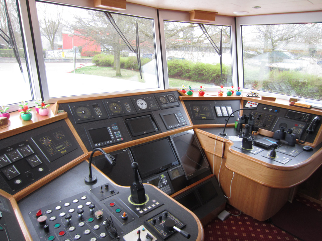

    The retractable wheelhouse of the river cruise ship, not my boat of course :). The same controls but better screens and no stupid toys on the dashboard, of course. When the wheelhouse is fully retracted, the skipper stands behind the controls and sticks his head through a hatch in the wheelhouse roof.
