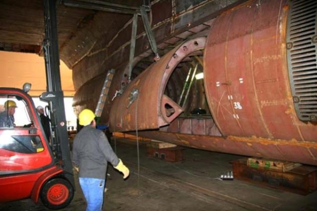

    That is common procedure in steel megayacht newbuilding and repair. How will you get a MTU 16V 4000 or a Cat 3516 in and out of the engine room, when the superstructure is already installed. Otherwise you would have to install the engine in an early stage of the casko build.
    An MTU 2000 series or an Cat C32 might get through an engineroom hatch in the salon and out through the big salon door but none of this big bangers.
    Below an example of the newbuild of the swath yacht Silver Cloud, where the complete floating Hull and superstructure arrived at the yard and then a hole was cut in each "torpedo" to install the machinery. Welding techniques are so perfect nowadays, you would not notice the cutout after the build or the repair is completed.
    Big merchant ships are even cut in half to install a new engine.
    Boats made of GRP or CRP (even worse) are a different story. But on most of those (smaller) boats, the engines will go through the aft deck (hatches) or the salon. On carbon reinforced plastics for example, the cutout needs to scarfed or spliced at an slope of 1 to 100 or more, which means, in an small engine room, you might to be forced to cut major frames or watertight bulkheads.
    Will say, an engine that can be dismantled in such small pieces that it can be carried through the engine room door, would be a great idea for repowering and repair.
    I wish you all the luck, you need for that adventure, to place a new marine engine design on the market. Bigger ones have given up before (like Volkswagen or Mercedes).
