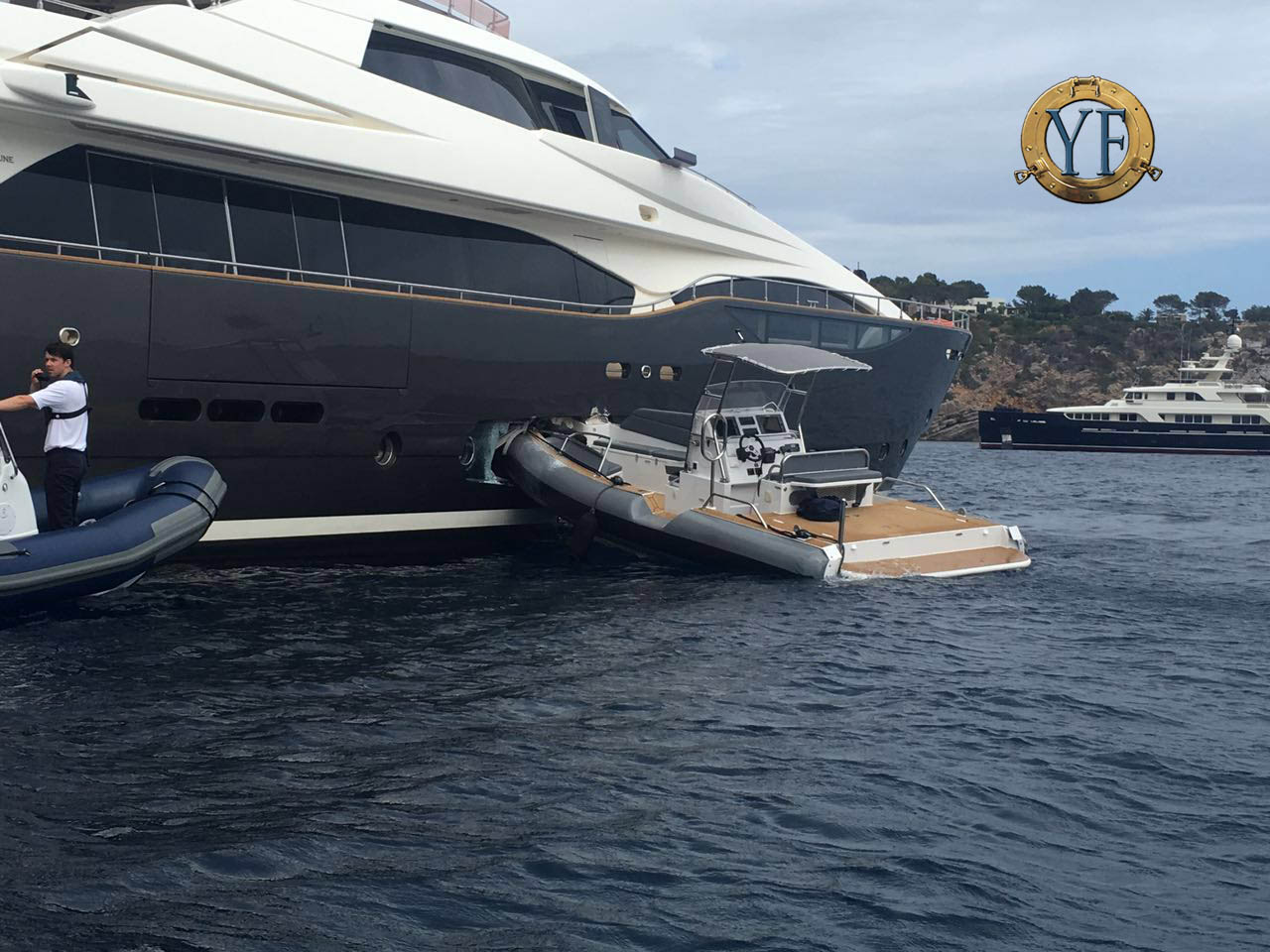

    Was just sent this new docking system and asked for my thoughts, I am told it allows the tender occupants to be delivered to the top deck in one quick movement.
  2. HTMO9
    HTMO9 Senior Member
    Jan 13, 2009
    1,682
    That looks like a Custom line 124. I hope it is the boat of Silvio Berlusconi.
    He would deserve it :). Just joking. Hopefully nobody got hurt?

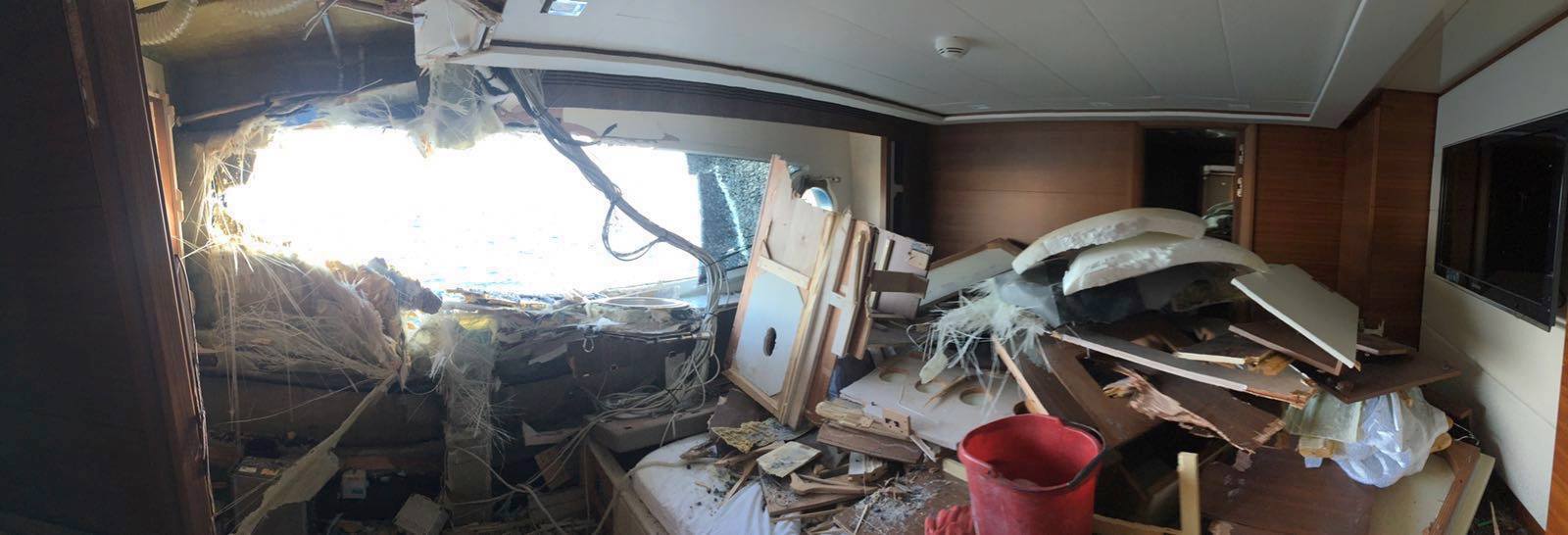

    Curious as to how a RIB could penetrate glazing like that? Dealing with a client at this moment that has Avmar Marine Glass retrofitting a 40 meter GRP vessel with a total of six large areas of glazing in the topsides. Also curious if the GRP flashing or receiver was damaged during this intrusion.
  5. K1W1
    7,427
    If it were moving at warp speed as the jungle telegraph suggests and there was anything solid at the front that could provide pinpoint loading it may well have penetrated the glass, it could have also just punched it right in.

    Either way, I highly doubt the RIB tender would have a chance of puncturing the hull of a yacht that size, had it not been for the window.
    Glass flexes a lot differently than fiberglass/steel/or aluminum, when you're getting loads on the hull, it has to weaken the structure or water tightness of the vessel to a degree no matter how well done.

    Those hull windows, even if made of multi layer plexi or other hardened glass are not as strong as they seem to be. They will for sure meet class requirements but they are weakened by design.
    Each piece of "glass" has two or three opening portholes built (means drilled) into them. With the high speed impact (I like that expression "warp speed") of a metal type bow fitting of that tender for example, there could be more than enough stress on this window to shatter into pieces.
    Those big windows might look great from the outside and make nice bright cabins and even may meet class requirements, they are big holes in the hull structure.

  16. Capt J
    14,531
    Could you imagine if you were laying in bed when it happened!!!!!
    What happened here, the tender was cruising along at 35 knots and the driver not paying attention to a huge yacht and ran smack dab into the side of it?
  17. HTMO9
    HTMO9 Senior Member
    Jan 13, 2009
    1,682
    Both crewmembers fell of the tender at high speed and none had the kill cord connected. The tender was circling around unmanned at high throttle setting for minutes until it crashed into the CL 124. A real nightmare.
    IMHO, the insurance of Le Grand Bleu will ask some questions before paying anything (if at all). This season is over for the yacht with this amount of damage.
  18. T.K.
    T.K. Senior Member
    Jan 31, 2007
    1,011
    Cairo - Egypt
    What are the odds of aiming into the side window of a 38m yacht with an unmanned tender!!
