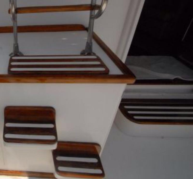

    I will be redoing some of the teak trim on my Post, while leaving any teak sections that might be underfoot unvarnished. However, as the picture below shows, it seems that perhaps applying nonskid strips to step surfaces might be an option. Here you can enjoy the nice varnished finish while at the same time reduce the chances someone will actually experience a significant orthopedic misadventure when he encounters the step surface.
    Does anyone have experience with these nonskid applications? Do they hold up? Do they work as intended?

  12. P46-Curaçao

    I would suggest for the horizontal pieces, King starboard anti-skid, marine-grade pieces with diamond pattern to prevent slipping and promote drainage.

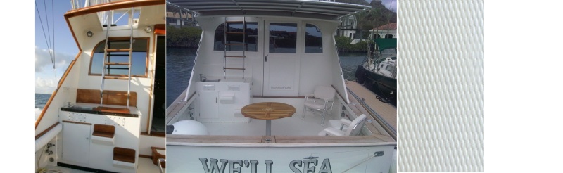

    If you have a router, buy a sheet, cut your own pieces and route a nice half bull nose on it. I replaced and updated a lot on my Post, see the result below...
    Starboard is also easy to clean and won't rot!

    Now on the flat surfaces it looks like you removed the teak altogether and replaced it with the King Starboard non-skid. Is that correct?
    I am assuming you used counter sunk stainless screws to fasten the starboard to the mounting surface. Looks nice.
  14. P46-Curaçao
    P46-Curaçao Senior Member
    Mar 8, 2013
    734
    Yes, removed all 'step on' horizontal pieces. (already made, but need to change the ladder steps)
    I fastened it with just a few s/s screws from below (not visible) plus 3M 4000UV sealer, so it can be removed is ever necessary.

    Yeah I agree. Looking at Curcao's pics he put the starboard onto the existing moulded steps. I would do the same if I went that route. When I was inquiring of removing the step first I was referring only to the teak, not the moulded step.
    I'm still undecided how I want to do this project though. The starboard works nice for curaçao cause he also painted all of his trim (window trim, box trim, steps) white. I'm not sure how the starboard would look if I kept the other teak varnished instead of painted. Probably ok, but not totally sold.
