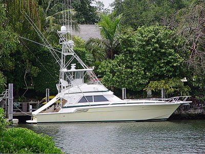

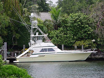

    Second boat with a PipeWelders Tower and custom railing. 26 years old and still shines like new. Suspect may have been Ceramic Coated but just a guess as that was the only product that brought the aluminum on previous s/f back to life of shine. Would I build a new one; probably not but in this case was part of the package.
