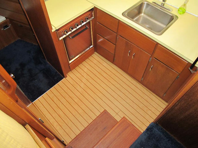

    Thanks guys. I just received samples and an installation quote from a guy who represents Nuteak/Cflor.
    Eric, I just ordered a sample from Lonseal, thanks for your thoughts!
    he Nuteak is going to cost roughly $2,800 for 240 square feet. His installation price was pretty high at around $5,000. He said it would take almost a week to install. I've done plenty of flooring including the fake bamboo currently there which I did in a pinch two years ago. I wish I had gone the extra mile as it just looks cheap. Now I get to do it over again!
    Now I just need to decide which product to use. If it's the Lonseal which comes in sheets, I'll carefully remove what's there now so I have a perfect template to trace. The Nuteak looks incredible but it's time consuming as it comes in 3" strips and the 1/4" holly gets glued down separately.
