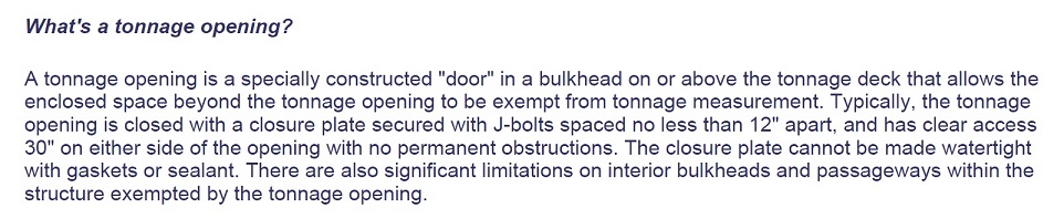

    Google "tonnage openings" to learn how such design features are used to circumvent certain regulatory issues related to tonnage measurements. Read the class rules for specific requirements.
    Generally, no. Flag states may dictate specifics but typically any tonnage hatch or closure must be equal in strength and watertight integrity to the surrounding structure.

    I found the following definition for a "tonnage opening":
    Does the above mean that a side opening such as the one shown in the image below can be closed applying the method outlined in the above statement?
