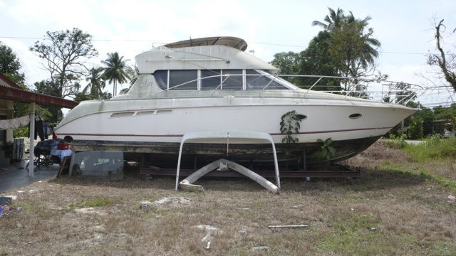

    Hi all,

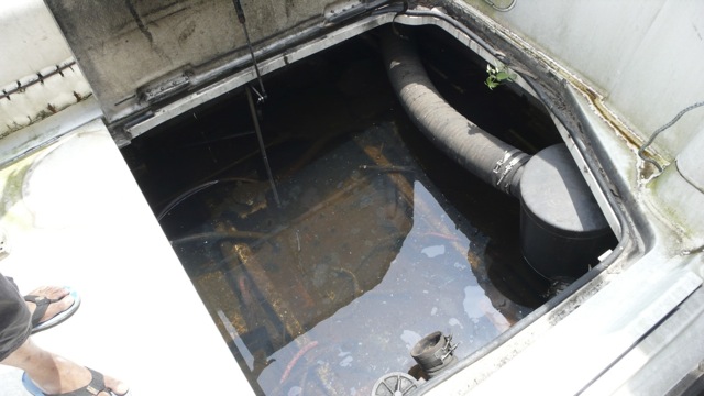

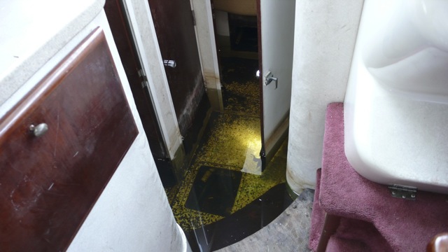

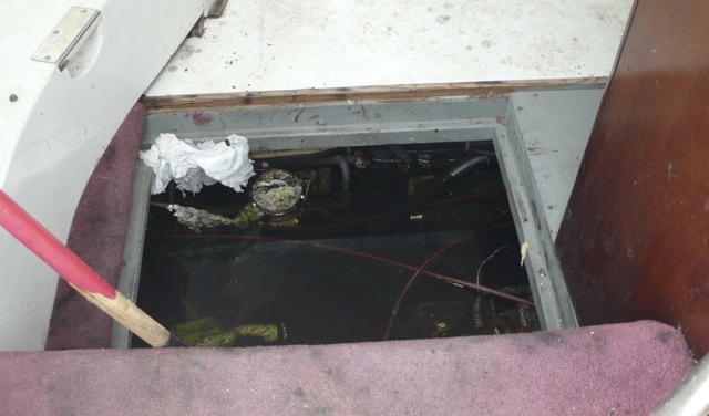

    This is my first post to this forum. I have not yet become a boat owner, but the time is closing in fast. I've been looking for a renovation object, something that will keep me busy for a few years forward, and I came across this very badly kept Silverton 362 from 1995. It's basically been laid up for a couple of years in the sun, with no protection whatsoever. What's worse is that rain has seeped into the boat and filled up a rather large part of the bottom hull, just below the floor planks. This has been going on for quite awhile... the "caretaker" told me that he usually empties it out after a heavy rain.. but since the water was still there when I came to look at it, I doubt this ever got done. Good intentions that never got done I figure...
    My question to all you experts in the know... is a hull that has had this kind of damage worth resurrecting? As far as I know, this particular Silverton have a solid fiberglass/composite hull... not cored. Has water seeped into the fiberglass and caused structural damage? Perhaps the wood has been damaged inside too?
    I'm trying to get hold of a surveyor to go check it out, but wanted to hear any feedback from the forum first... perhaps someone been in the same situation and gone through a major hull repair as might be necessary here. I'm prepared to redo the gelcoat and repaint... but if there is major structural damage I'm in over my head.

  2. NYCAP123
    11,208
    Before you hire anyone use sweat and do the cheap stuff. 1) empty and dry the boat. (The drying may take a while. 2) Once dried start tapping with a knuckle. Listen for that thud that indicates rot. 3) check it with a moisture meter.
    That said, I think this boat has probably been abandoned for good reason. It will certainly cost way more than what it's worth to restore.

    i can't believe they didn't dried the boat yet...that would be my first task after taking that one out of the water...
    turn it around and dry it, then try to have a look at the structure, if thats in good condition - what i wouldn't believe - may have a try at restore it, but with that mold - naa wouldn't be worth the sweat

    Just looking at the obvious damage, I would suggest running away from this one, as these things tend to hide the majority of the real problems.
    A lot of the time, spending bigger money on a turn-key boat is far less expensive than rebuilding junk.
    But then again, if the price is right (really really cheap or free) and you have too much time on your hands and always wanted to be a shipwright or are a glutton for punishment, then go for it.

    the only concern from a structural point of view are the stringers. Some builders used wood stringers and didnt' do a good job sealing the wood. Water gets in (even if it's not a sinker like that POS), wood rots and the stringers are done.
    but even if the stringers (and bulkhead if they used wood) are good, fixing this boat is going to require a ton of work and parts. Even if the engines have been properly stored, you still have do deal with wiring, generator, pumps, air cons, fridge, etc... which are all likely to be toast. what about the fuel tanks?
    as to the engines, why were they removed? you dont pull inboards when storing... and even if they were un damaged, how where tehry stored.
    yikes, even free rebuilding this boat may coast more than one that's in good shae...

    Thank you all for your feedback, I appreciate it. I've decided to pass on this boat, even though my hands are itchy to restore it. With what I've read here, it is most likely that there is rot in the wood and the hull requires major work. I feel comfortable with fixing some glass cracks and applying a new gelcoat... but to replace stringers in a boat as big as this... that's too much of a risk with my skills. If I would ever get that job done, I'd freak every time I hit a wave in panic whether my structural work was properly done. Furthermore the electrical systems are done for, and would require complete rewiring, as well as every major and minor system in the boat. I couldn't see the conditions of the tanks, but I would take a gander that they are in the same sorry state as the rest of the ship.
    The engines were taken out when the boat was laid up. As far as I understand it, one of them had a sized piston. My thinking at the time, when the adrenaline was clouding my judgement, was that I would re-power the boat with two truck diesels. It's fairly inexpensive to do that out here in Malaysia. Manual labour is also cheap, which was one of the main factors that made me start thinking of doing a major renovation like this.
