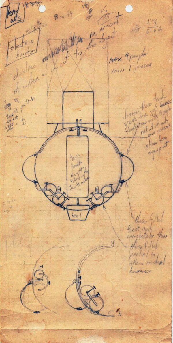

    Turns out I had an interest in submarines long ago,...back in high school so it would seem.
    I was just searching thru some very old files of mine, and happened upon a rough sketch I had made when first planning a high school science fair project.
    I wanted to plan out (and build) a small submarine for my science fair project for that year. I had located an old double-wall steam boiler taken out of a decommissioned army barracks complex (father was in the army at the time). I intended to cut 55 gal drums in half and weld them onto the outer surfaces of that steam boiler to act as my ballast tanks. Then compressed air tanks (from another surplus source) and valving could be made to alternately flood and blow the ballast tanks.
