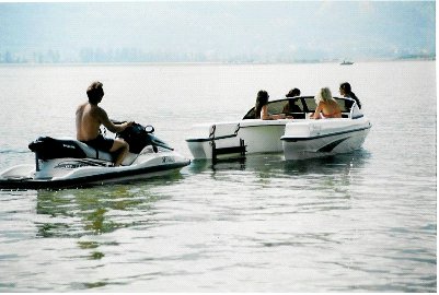

    The idea is not bad, perhaps not as a tender but otherwise. In reality though, several attempts to sell similar concepts seems to have failed. Even one of the big PWC manufacturers had one on the program, but I can not find it today.
    I found this one though: http://www.jetmate.com
