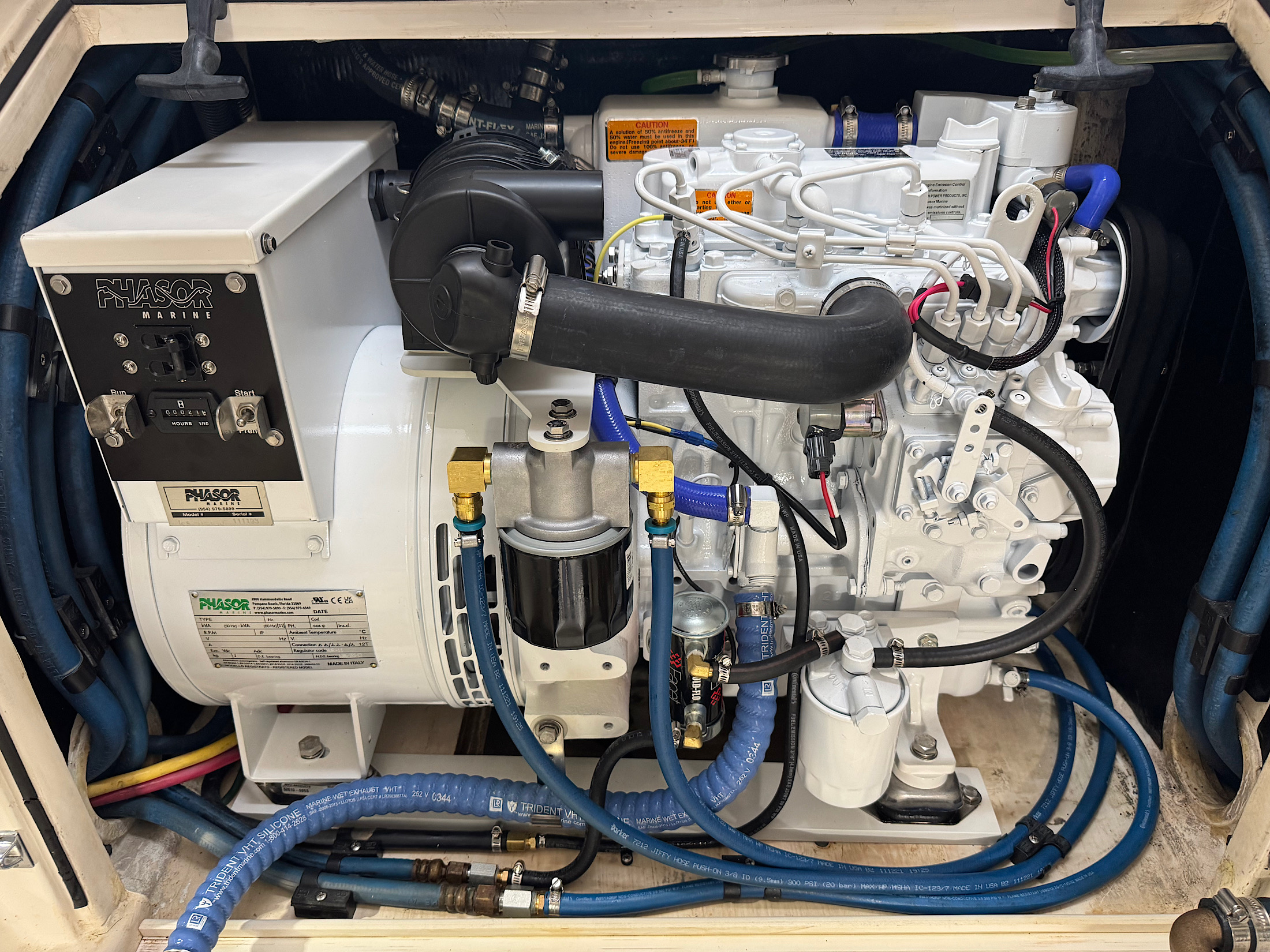

    I have a little over 650 hrs on my Phasor 8 Kw. and We are also happy with it.
    I have never run mine 24/7 tho.
    I think the longest continual run time was 10 hrs on the hook.
    I sort of have an aversion to running it when I am not awake and on the boat.
    I do see others run their genny's at a restaurant or dock bar, unattended, but I can not do that and relax.
    The Phasor is more quiet than the original Onan and my marina is a dealer/service tech location.
    I did have a leaky water pump on the new genny a[immediately after installation.
    It was leaking oil out of the port you would expect to see a water leak.
    The dealer replaced the whole pump no questions asked,
