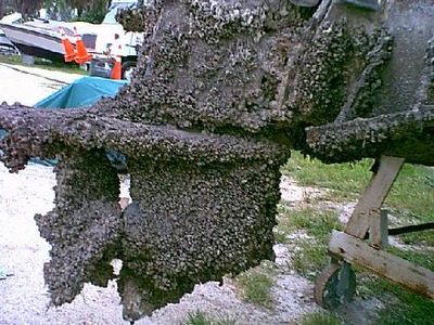

    I've seen lower units that looked almost as bad as the one in Carl's photo on the lake, boats that had been neglected and left in the water for years.
