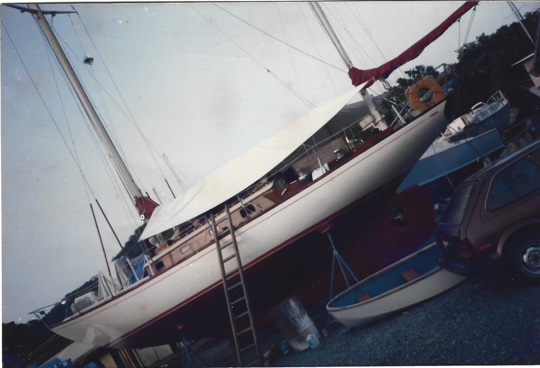

    It was an old classic wooden boat custom built by a well known yard in Maine, US 1956.
    Double planked mahogany hull and teak decks.
    Lots of external varnish.
    These boats can last for a hundred years in cold climates like Norway where there are thousands of of them, in the tropics not so much.
    The next owner of the boat fiberglassed the hull and bought more time for the boat.
    My experience was this: A maintenance nightmare, a pleasure to sail and a pleasure to look at. IMG_8342.jpeg
