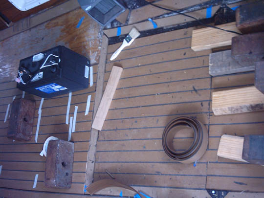

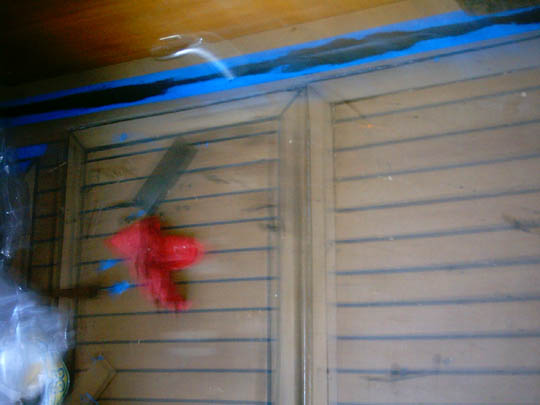

  12. alloyed2sea
    alloyed2sea Moderator
    Jan 28, 2004
    872
    Alex, VA
    Installation's a PLus+
    Alot better than sitting on the shelf - where half the glue dried out anyway.

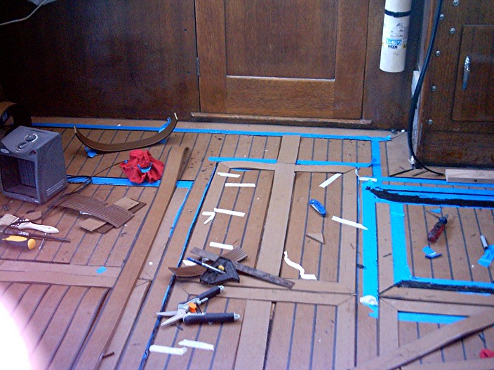

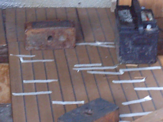

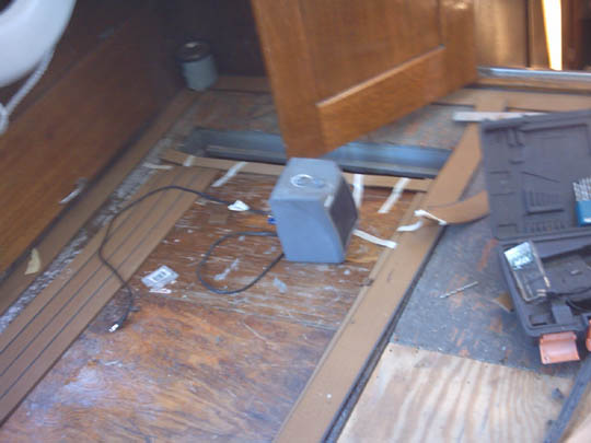

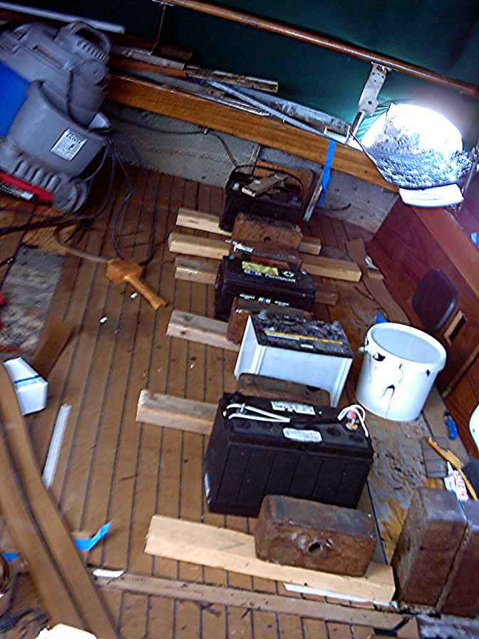

    Here there are, the "during" shots - as we "install" the TEK-DEK - yaaah!!!!

    Tek dek is easier than teak parquet???
    Ok Eric, If you say so!!!
    Looks like a lot of work unbolting the batteries from the boxes and then stealing all of that gold bullion as weight from FT Knox.

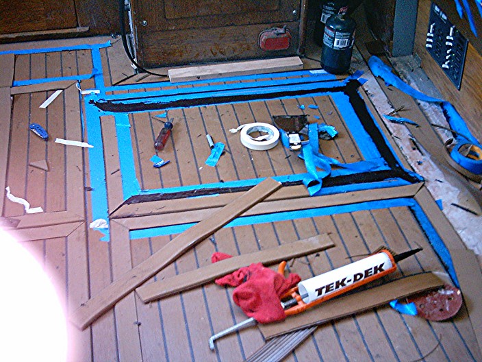

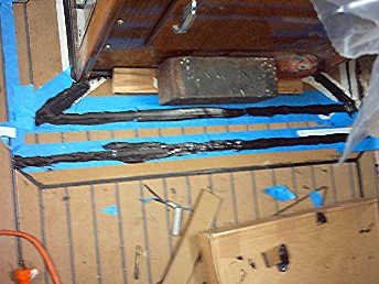

  16. alloyed2sea
    Jan 28, 2004
    872
    Alex, VA
    More photos of installation....

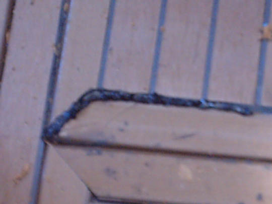

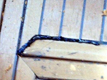

    ..., taken by our onboard combat photographer (ps - the following photos are not for the weak at heart).
    No, it's not a job for amateurs. I can do wood, electrical wiring, etc, etc.,...., but installing TEK-DEK requires a full-time effort undertaken by someone who capable of getting the "big picture" even as she or he struggles with the nuances of joining "boards" with SteelMax and accomodating the inconsistencies inherent in any boat deck. :eek:
    For example, to start with - all decking was replaced with marine grade plywood and then we faired surfaces out with fiberglass (especially in areas known to collect water). THEN, we started to plot out our attack.
    Were it not for the full-time participation of my boat "mechanic" - this job would be continuing to lanquish - instead, itz finally done. Photos of that to follow....
    Bottomline: Nautolex is just fine/keep her covered to minimize the inevitable deck wood rot. TEK-DEK looks like a very good LONG-term solution - itz armor plating for what was always the weak spot in Riviera 37/38s: the aft cockpit.
