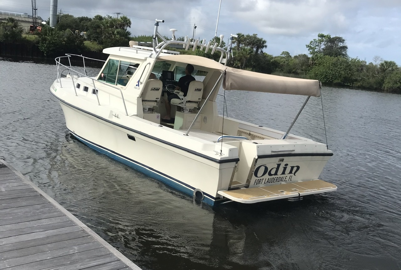

    I did the cruising on a sport-fishing boat for 5 years, but on a small scale:
    Albin 28TE. (TE for Tournament Express)
    It worked out great: the big aft fishing cockpit was great for lounging and entertaining, very comfortable for one couple on longer trips, or 3-4 guys on short hops.
    Economical doing trawler speeds @ 8,5 knots with the single inboard diesel, or run at cruise speed 17 knots to the Bahamas and back. The deep V hull handled the seas well for it's size.
    I never fished a minute on that boat, but it did cruising very well, Dual Purpose indeed.
