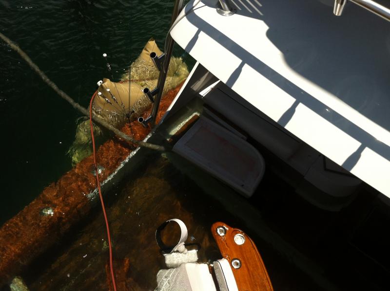

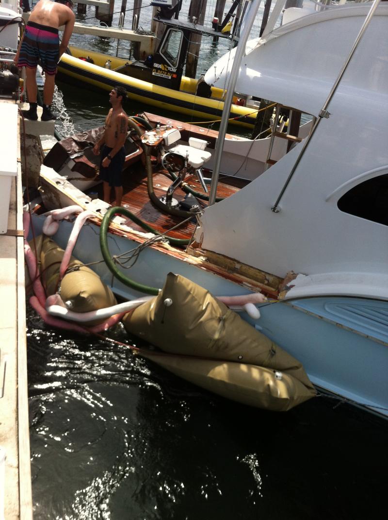

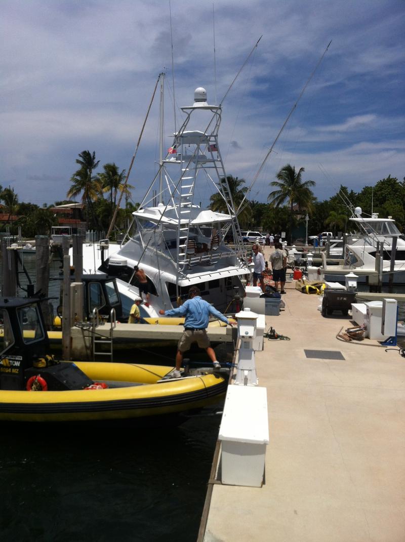

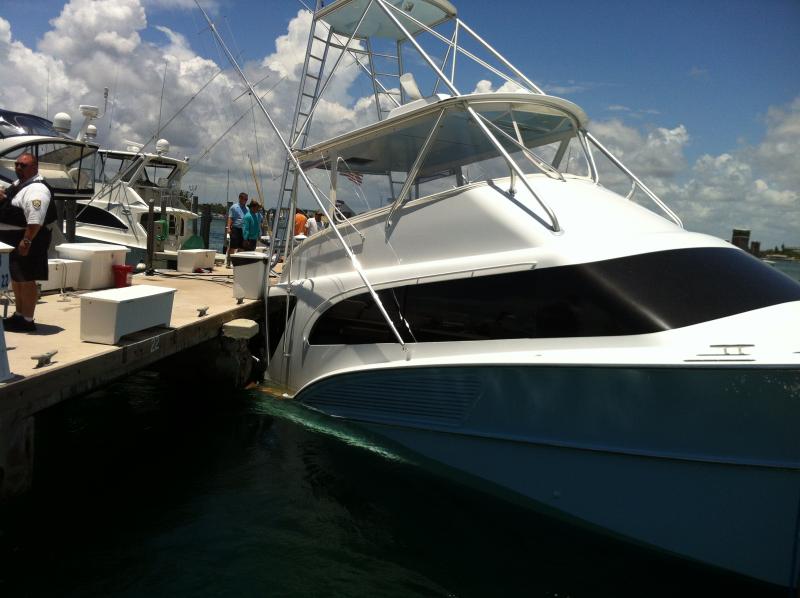

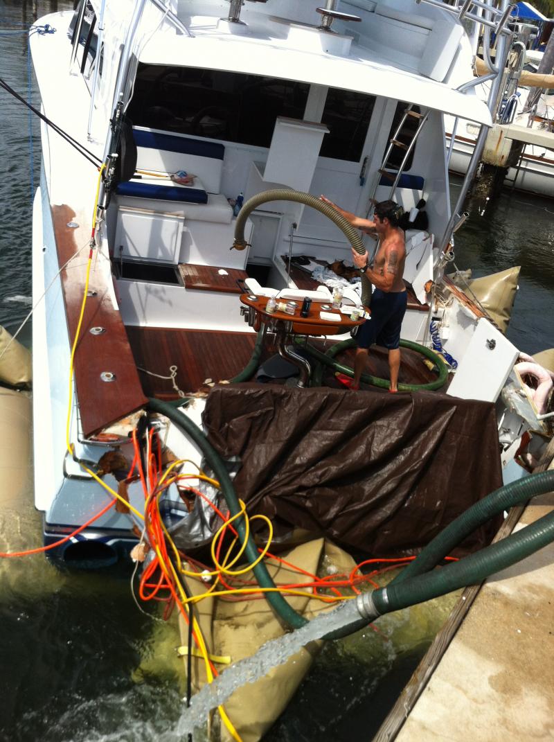

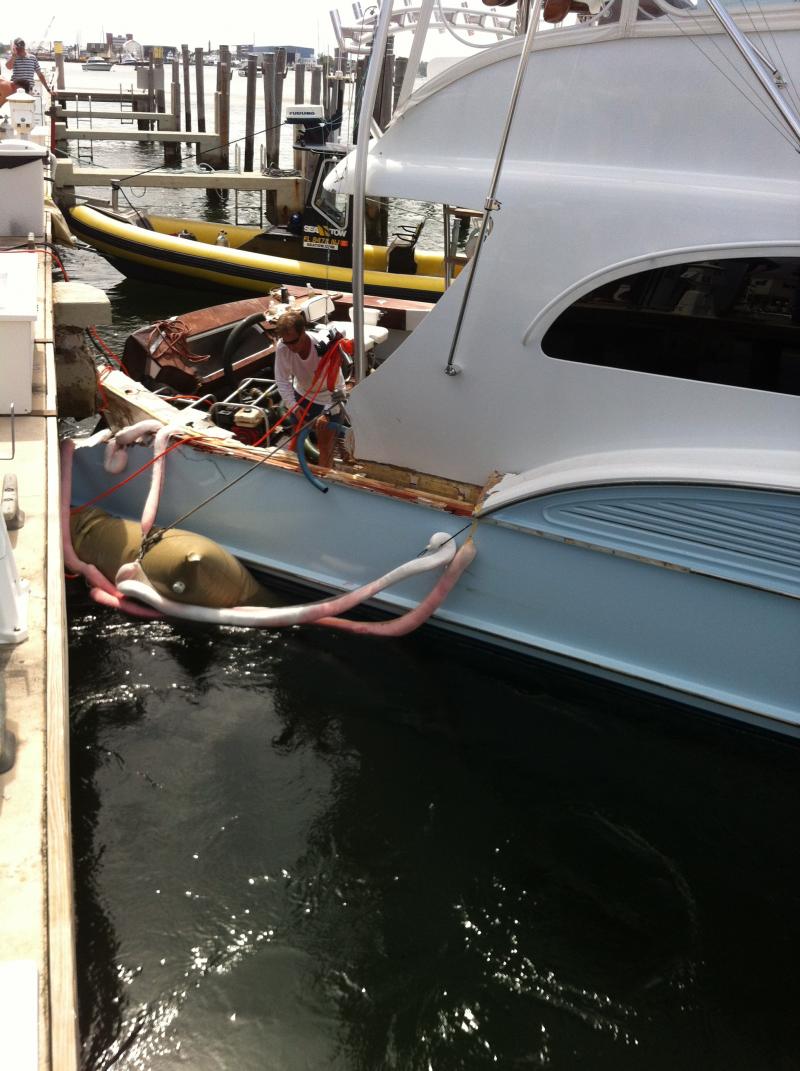

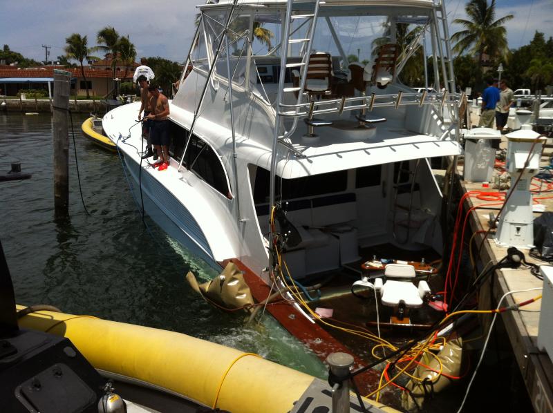

    Sailfish Marina (Singer Island- Palm Beach Shores, FL) north dock, north side. Just south of "The Buc" marina to which the "Silver Fox"- a 58 Scully- was going into it's slip. At least four on board, no major physical injuries to persons onboard was the report; boat's gear was stuck in reverse and the engine(s) rpm climbed rapidly. Actions by the captain did not changed the rpm's climb; place gear/throttle levers to neutral/forward; reportedly hit the "stop" buttons all had no effect. MTU V-10 M93 (common rail) engines. Captain is well respected and experienced; did not appear to be his fault- was a electronic gear error/runaway diesel. Took out at least one piling and the concrete finger pier then stopped by the concrete main pier. SeaTow on scene within minutes via land and sea with lift bags and pumps Supposed to be transported/towed to a haul out facility within an hour of my last pics. I cannot verify 100% all of the above so you might as well consider it my opinion and not fact.
  2. Bamboo
    Bamboo Senior Member
    Dec 19, 2008
    934
    Palm Beach, FL
    A 68 foot, not 58 Scully. Not the V-10's M93's. All agreed (that I spoke with) that it was due to control failure; that's what it looked like and that's what the captain said. One engine died, the other stayed in reverse, then went right to full throttle. Hit the dock about 2100 rpm. Glad it was near high tide as the boat hit the concrete dock after taking out a finger dock. If it was low tide the cockpit would have gone under the dock and then the house/salon would have stopped the boat's backing motion.

    I spent three hours helping them with the response. Great owners of our local franchise; it was clear even with a full staff more hands were needed and I knew what to do and when to do it. Boat was scheduled to be hauled out at the Viking yard just across the way. The Viking Manager on duty (whom I used to work with when I was employed there) made a couple visits over before the haul.

    No I don't know how the engine was stopped. When I got there the engines were not running and the boat was floating but taking on water. I ran to get my 110 emergency pump and hose but when I got back in 3 minutes it was a bit too late and plus the dock's power was cut off by marina staff for safety reasons.
    I could not speak with the captain- he was a bit busy talking with more appropriate persons. Initially I was told the boat is a 58, then a 68, I don't know for sure but there is another Scully on our our dock which claims to have the same engine package which is why I said what engines it has. I cannot tell you exactly what happened because I did not see the actual crash. I spoke with my captain peers who did however. One theory of being a "cowboy" who backs into a slip high speed is clearly wrong- he was not even trying to dock at that marina- much less that slip.
    I wish I did know how he got the engines to stop, and I know we all wish we knew the actual reason for the controls to not respond to the inputs from the helm and instead tell the engines and gear to do what they did.
