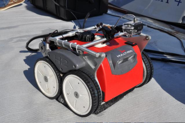

    Well how about this... It claims to be the world's first remote controlled hull cleaning robot for yachts.

    Parlez vous Francais? HULLTIMO 2 Haute definition - YouTube

    He did not explain what keeps it to the hull instead of sinking or floating..? I would have understood if it was a steel hull and magnetic, but this is beyond me...:confused:

    I think it is kept in place by suction. If you notice the shots of its activity underwater shows the white shoot in the middle is pushing the water out and away from the device, I think this creates vaccum between the hull and the bot so it clings by suction. Just a wild guess!

    Well that is the most plausible answer.

    As I watched the video it reminded me of the action of the type of scrubber used in a swimming pool. In that application, it's not the suction that keeps it against the bottom of the pool, but the jet of water that is pushed out the top of the scrubber.
    Alfred described above the "white shoot in the middle pushing the water our and away from the device". IMO it's that jet of water shooting out that holds the scrubber against the side of the hull.

    So we agree on the port but not the force in action! ;)
    I agree with you that the vortex caused by the water pushed away from the hull is what makes it stick, describing it with "Suction" was not so right after all. Thanks.
