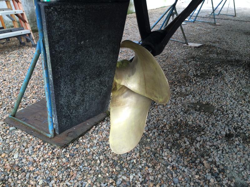

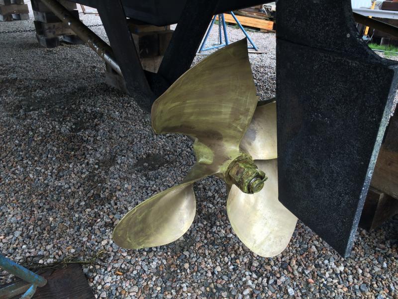

    When I came down to my boat this weekend, I was a bit shocked when I came in to see a Post 50 up on the hard by the travel lift. For a second, my heart was in my mouth, thinking something happened, but then I saw the blue accents on the hull and knew it wasn't me. But some poor soul had a bad day. From what I was told, they hit a log crossing back to LIS and had to be taken in to Pt. Judith as she was taking on water from the hit to the shaft. You can't really see from the photos, but the shaft is wedged right up against the rudder. Yeowch! Hope its just a prop and shaft problem :(

    Good week out on the boat, bad day traveling back. tranny is cracked in
    half also. Everyone is ok and wants to get back out on the water.

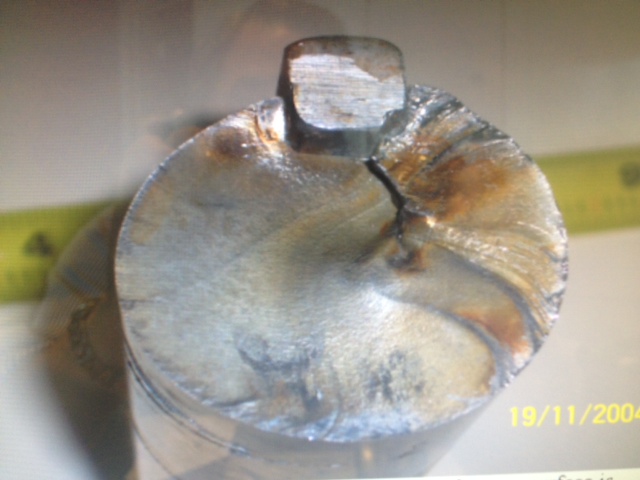

    Fluxing and Lapping
    Easier than it sounds. Fluxing a shaft entails painting a purple colored liquid onto the shaft behind the strut after you have removed the prop. Once the liquid dries, you spray it with an aerosol solvent that removes the dried flux. This leaves the purple color in any surface crack, easy to see with a magnifying lens. Typically the cracks start in the corners of the key way slot. A way to prevent this is to chamfer the corners rather than leave them square. When I lost the prop I spoke to several other owners including someone at Post and was told repeatedly that 50's have had shaft failures at the taper just under the prop. It may have something to do with the dimensions of the early 50's. I have 2 1/4 inch shafts and the prop is mounted about 2 1/2 inches behind the strut. This may cause a flailing action on the shaft weakening it over time. The metal lab that checked the prop said it was a long slow crack over time.
    Newer 50's I believe ran larger diameter shafts due to more horsepower, but potentially to correct this issue. I have had my chamfered Aquamet 22 shafts for about 10 years now with no problem.
    Lapping is just coating the shaft with an abrasive compound, then installing the prop without the key and turning it by hand for while so the taper of the shaft and the prop mate up better. Reduces the chances of any play in the shaft/prop connection that can lead to cracks by overstressing the key way.

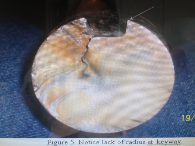

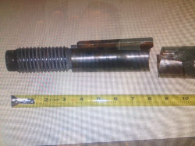

    Here is the lab report and pictures:
    Presented for analysis was one 2 ¼” diameter marine shaft in two sections (Figure 1). The tapered portion of the shaft was fractured through the keyway region. The “beach mark” appearance of the fracture surface is indicative of high-cycle, low-stress fatigue (Figure 2). There are multiple crack origins both in front of and behind the key as indicated by the arrows seen in Figures 3 and 4. These multiple crack origins and cracking along parallel planes is also a characteristic of high-cycle fatigue. After initiation, the fatigue cracks slowly propagated through the shaft until the remaining cross section is no longer able to sustain the applied stress. The last portion of a fatigue failure is referred to as final or fast fracture. There was very little material left on the shaft before final or fast fracture, confirming that the stresses responsible for the cracking were relatively low.
    Also noted was the lack of radius along most of the length of the keyway, as seen at the edge of the fracture surface in Figure 5. Radius was present at base of keyway. The sharp edges acted as a stress concentrators and crack initiation sites. In General approximately ninety percent of a shaft life is used to initiate a fatigue crack. The crack then propagates through the shaft for the remaining 10 % of shaft life. Conditions that help initiate cracks can therefore significantly reduce shaft life.
    Chemical analysis was performed on the shaft using optical emission spectroscopy (OES). The results are attached to this report. The chemistry was consistent with Aquamet 22 type stainless steel. This is a higher strength grade with slightly lower ductility compared to Aquamet 18 or 19.
    As a result of the above investigation and analysis, it is apparent that the failure was due to high-cycle, low-stress fatigue occurring over an extended period of time. As to the length of the key, the use of reduced keyways and keys is sometimes used to reduce stresses on the shaft. The fact that a slightly longer key could have fit in the keyway, is not the cause of this fracture. However, according to SAE Specification J755, fillets are mandatory for keyways in shafts above 2” in diameter. This specification requires a 3/32” keyway fillet radius on a 2 1/4” diameter shaft. The lack of this radius contributed significantly to crack initiation and ultimately shaft failure.
