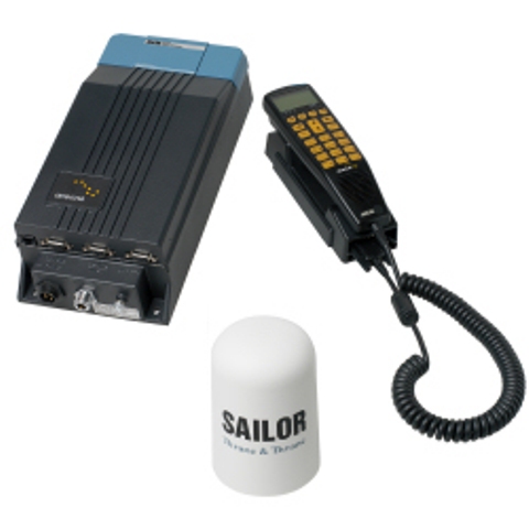

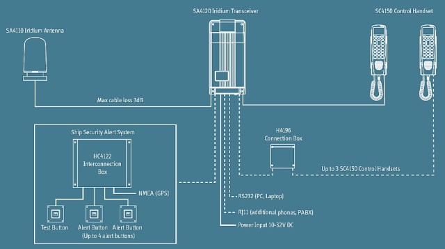

    Our SSB transcievers are mostly used for AM radio (music) reception by the crew. For communication and the net, we use our KVH antennas and for crew communication, the Sailor Iridium system with the crews provided with prepaid Iridium packages. Works quite well and the crews are happy.
