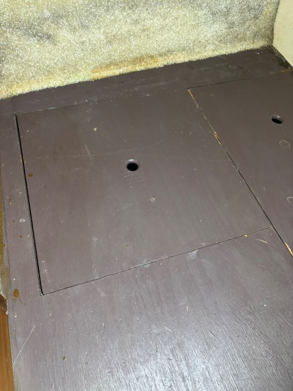

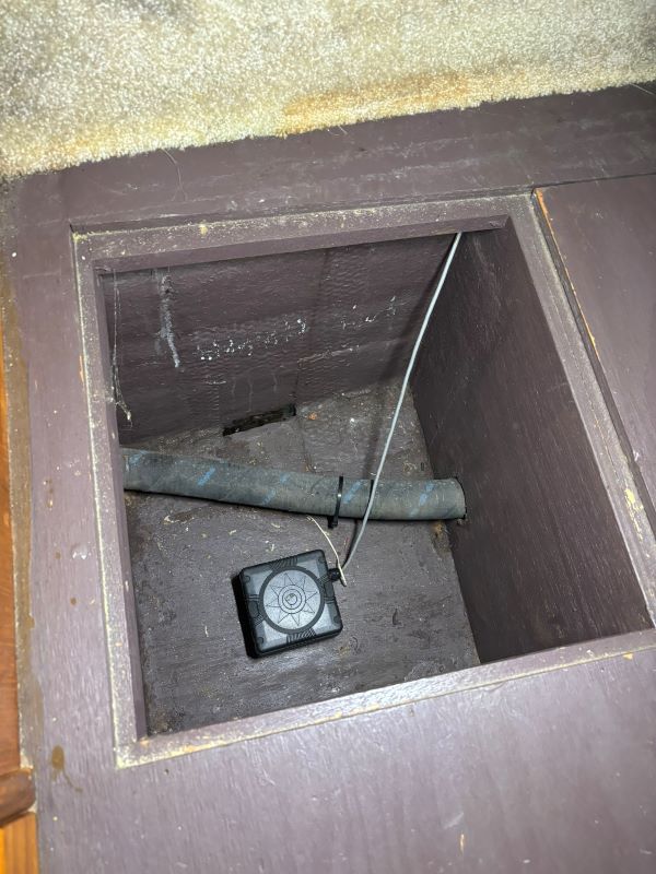

    Original AP sensor unit on my 43 is under the guest room lower bunk toward the hull and forward of the holding tank.

    I was surprized when I first found it as the Garmin AP sensor is nowhere near.
