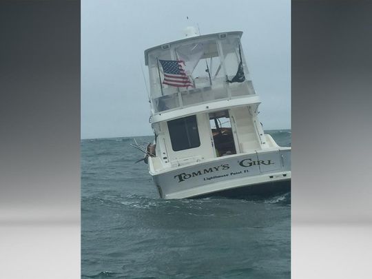

    does anybody know the story behind the foredeck failure on this boat?

  3. K1W1
    7,427
    Looks like a bit of slamming caused the tabbing to break and the foredeck came loose.
    Bit of pushing about and some more mat and polyester and it will be as good as it ever was.

  7. Pascal
    8,546

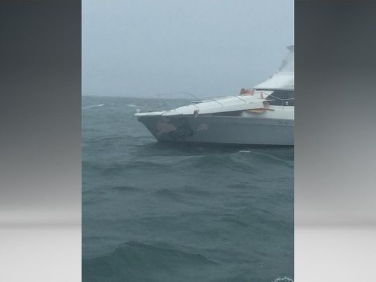

    I wonder if maybe they didn't hit something. There seem to be quite a bit of damage to the hull, not just the deck
    In any case not confidence inspiring especially as this is not the first time a silverton breaks up

    I didn't see the hull damage on the video, but see it now in the photo and definitely looks like more involved.
    Looks like an Arizona Cardinal being welcomed by Carolina. Guess they didn't know the Cardinal is the state bird of NC.
  9. Capt Ralph
    13,442
    I was thinking they hit a ship till I noticed hull scuffs on both sides of the stem back a few feet.
    Unless they hit a ship, spun and hit it again.

    I cant explain the marks on the bow portion of the hull.
    If you take away the hull marks, what seem to make sense from the video and stills is that the hull and deck joint failed presumably from stuffing the bow during the conditions in the video.
    I think, the lack of impact damage to the bow pulpit tends to support a non collision impact.
    The deck appears as if it there was some upward force applied as the boat was moving forward causing it to lodge aft of its original position.
    It looks like the molded bow pulpit may have provided the leverage to lift the deck and fracture the deck where it meets the house and is presumably stronger.
    Generally, how is the hull to deck joint fabricated in a production fiberglass molded boat?
    is it tabbed with glass or just screwed together with self tapping screws and covered with a rub rail?
  12. Pascal
    8,546
    On better boats it is glassed over. On many production boats it is bolted
    And then you have the budget builders who just screw it with lots of caulking :(
    Not sure how Silverton did it but I doubt this was glassed

    I can't imagine that happening as a result of stuffing the bow. I owned a 1986 Silverton 40 convertible for 10 years and ran buzzards bay many times in conditions much worse than what appeared in the video. It looks like the pulpit hit something hard enough to push the whole foredeck backward after fracturing. It's also off center, but still intact. I've stuffed the bow on my Silverton, and anyone that knows Buzzards Bay Ma knows its possible 50% of most days in the summer, more than a few times and while the boat did shudder pretty good a few times there was never damage. I'd be very interested in hearing what really happened.​
