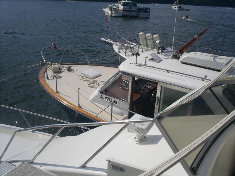

    Wood Rails
    Better to use Bristol Finish.
