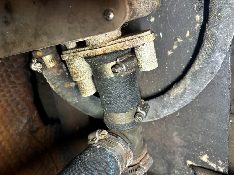

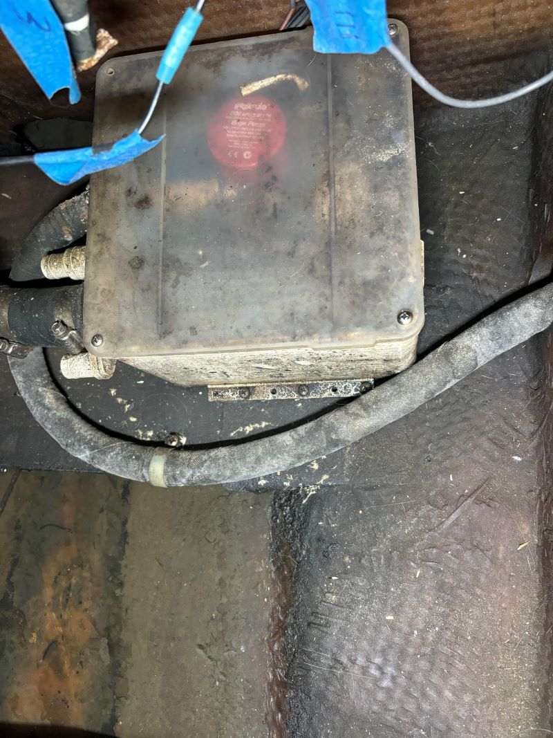

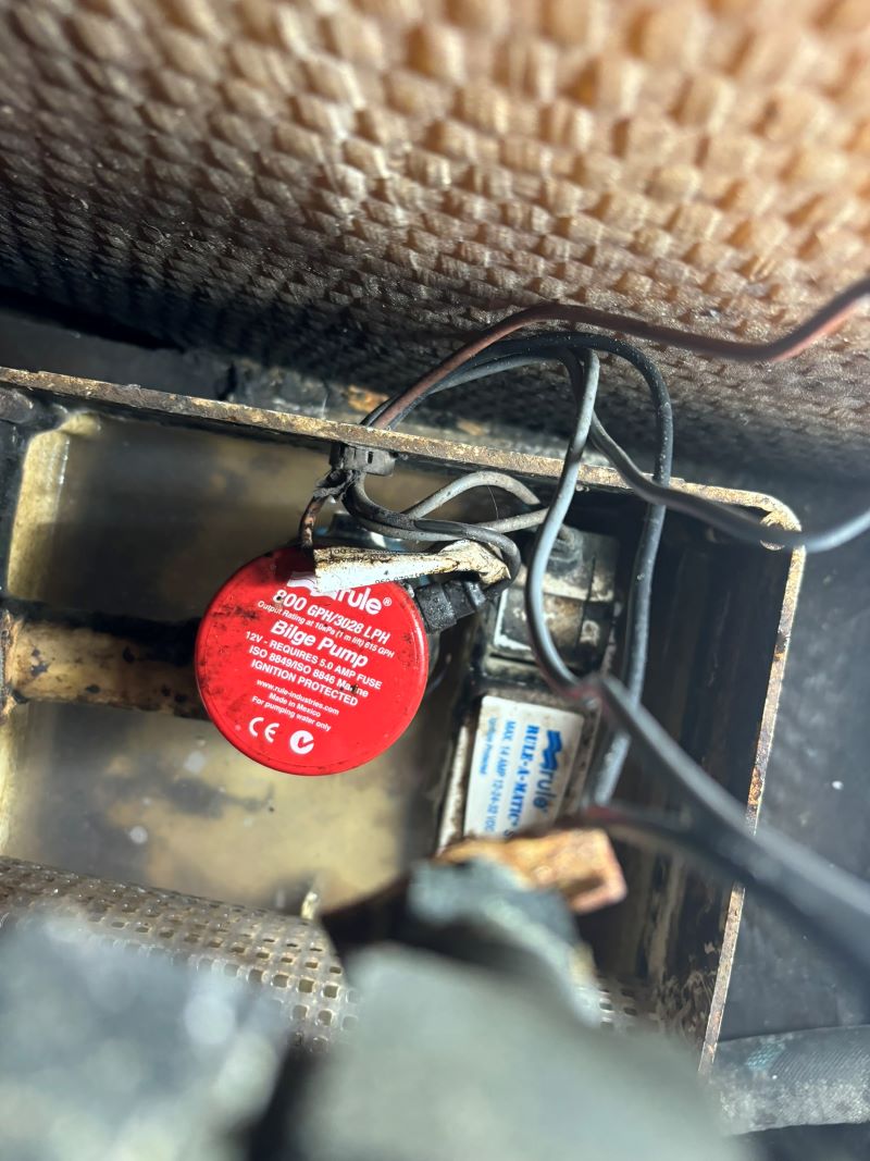

    Bought a replacement just like that unit at West Marine a year ago. It’s a complete unit that includes box, pump and float switch. Readily available

    That is the original Rule sump that has been modified to use the clip in/out float switch.
    Originally was the caged switch.
    Rule had abandoned their mercury switches many years ago and use a mechanical (cherry) switch.
    This later switch had had a lot of issues.
    We went thru a pile of them for us and our customers.
    Seems we went thru many before installing a good one in many installs. Those good ones seem to still be working well.
    If it is leaking current, swap that switch out and try again vs replacing the whole sump.
    Mind you the screw (mounting) holes do not match the original (caged) switch. Hopefully the original holes were sealed properly and the base of the new clip in/out switch was bedded correctly.
    Then clip in/out a new float switch.
    Many times the newer float switch interferes with the tubular screen. Watch out for that also.

    I'll have to pull the cover and see if I can find which switch it is. I've never seen a clip in/out one before. It was hard to get the screem to clear the float when I pulled it for cleaning.
    Rule says the 98B is a drop-in replacement, but it doesn't look like the 1.5" hose location is the same, so would probably need to seal old mount holes and move.
    Only issue with replacing the swtich is knowing which one and working through the wiring rats nest outside the box.
