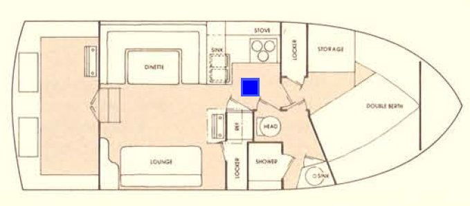

    I've an 1984 33' Carver Mariner. The Shower pump (not a sump pump)has failed. I can not access it. There is only on small floor hatch in the galley, no original plans. I fear the floor hatches were covered up with "Pergo " flooring. Does any one know where the pump is and how to access it and or the original hatch floor plan? Can't believe the only access is a 2x2 hatch in the galley, in Blue below.

    That position (between the head and galley) looks right. Yes a 2'x2' hatch sounds right and yes since 1984 it's entirely possible someone put laminate over the floor covering hatches. Easiest way to figure it out is to poke your head down and look at the floor from the underside. (A mirror or camera will help as will a small helper) The good news is that laminate flooring is floating and generally not glued down. So you can start on one side and uninstall it. Keep in mind this is your boat. So if you need a larger hatch, cut a larger hatch. Not sure what you mean by "shower pump (not a sump pump)" unless I'm misreading this and you have no water pressure and not that it's not discharging the gray water. Most boats your size will have a plastic box (sump) with a clear plastic lid although back in '84 it could be all plastic and hoses to it from the shower and sinks and a discharge hose from the pump. Inside you'll probably find a Rule bilge pump with float switch. Often that float switch will get hung up making it run till the pump burns out or down keeping it from operating.
    Now if it's a water pressure issue (only at the shower) that could involve major surgery, opening a wall behind the shower. Often the fittings corrode clogging the hose.

    Glue is not bad. They took an extra step to make sure the boards don't loosen up or squeak. Get out the jig saw and cut a hatch the size you need. Not surprised if that's the only hatch as the plumbing and maybe a bilge pump are probably the only things to access under there. Any chance you can take a pic o what you have under there? It sounds like you're saying there's a pump connected directly to the shower drain that you turn on with a switch for when you use the shower. In that case you have 2 possible sources for your issue. Have you checked that the switch is working and has power?

    Yes the pump turns on, makes noise but removes water at a trickle I suspect something is fouled, but if I can’t access it I can fix or replace it. You can see from the floor plan the shower pump is not under a cabinet. The shower drain is on the at the foot of wall between the toilet and shower stall.
