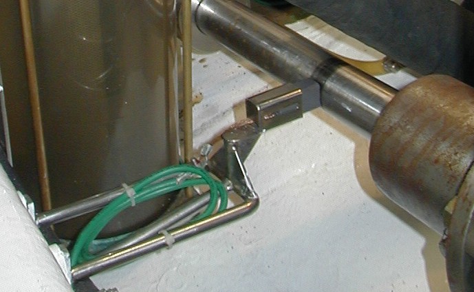

  3. musky
    musky New Member
    Jan 15, 2004
    4
    Kent Island
    The brush, or wipe is pretty substantial with heavy gauge wire, but I did hear you loud and clear when you said the connection has to be perfect with such low volt and amps. I'll keep one shaft zinc on per shaft just in case. Thanks for the response!!
