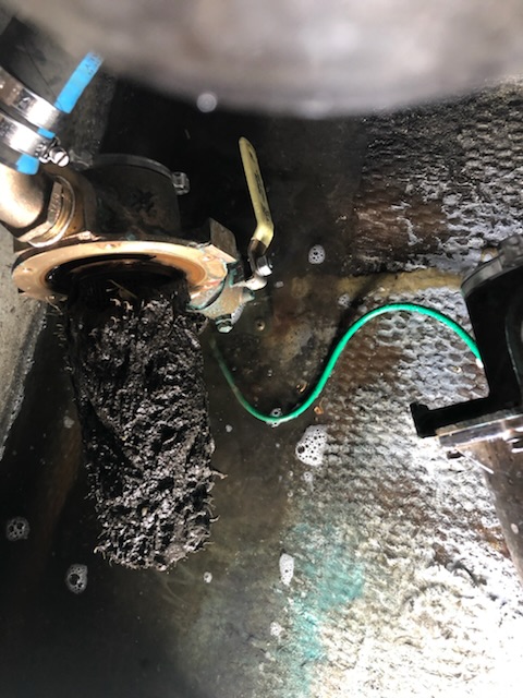

  10. David Helsom
    David Helsom Senior Member
    Sep 23, 2019
    129
    Sturgeon Bay/Fort Lauderdale
    This was after three weeks in January at Sunset Bay.
