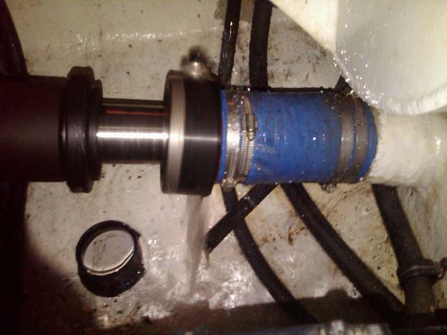

    Cap, same exact thing happened to me and nearly sank my 63' Predator. After this experience I vowed never again to use Tides.

    Judging from the picture above, I have to say it looks like you have (had?) a serious misalignment of the shaft inside the shaft tube which caused excessive side loading on the floating cutlass bearing and it finally seized on the shaft. Loss, or reduction of cooling water also can cause the same thing and we have seen engine zinc flakes and other debris clog the smaller diameter water inlet hose barb. We now install a fine-mesh strainer on the cooling water outlet ahead of the shaft seal and have not had a problem with cooling water loss since.
    I can't tell for sure from that pic and you'd have to take the entire assembly off to measure but if the shaft isn't centered in the tube, any type of shaft seal will fail in short order.

    No alignment issues whatsoever. The part that holds the seal froze against the shaft and spun around ripping the hoses and making the mess you see there.

    As I said, I couldn't tell from the pic if the shaft was centered in the tube or not. I have seen a LOT of boats that the coupling faces were aligned dead on to less than .003", but the shaft wasn't in the center of the tube. The bellows hose on the seals allows some missalignment, but not much. I just refit an older boat that the struts had to be moved because of this (they wore out the old PSS seals and cutlasses in a years time and thought that was normal). Usually, for a cutlass bearing to sieze on a shaft it is due to either a loss of cooling water or missalignment. I've found many yards only crack the coupling loose to check tolerances and don't bother to check the shaft tube, ASSuming it is right from the builder and we all know that isn't necessarily the case :)!
