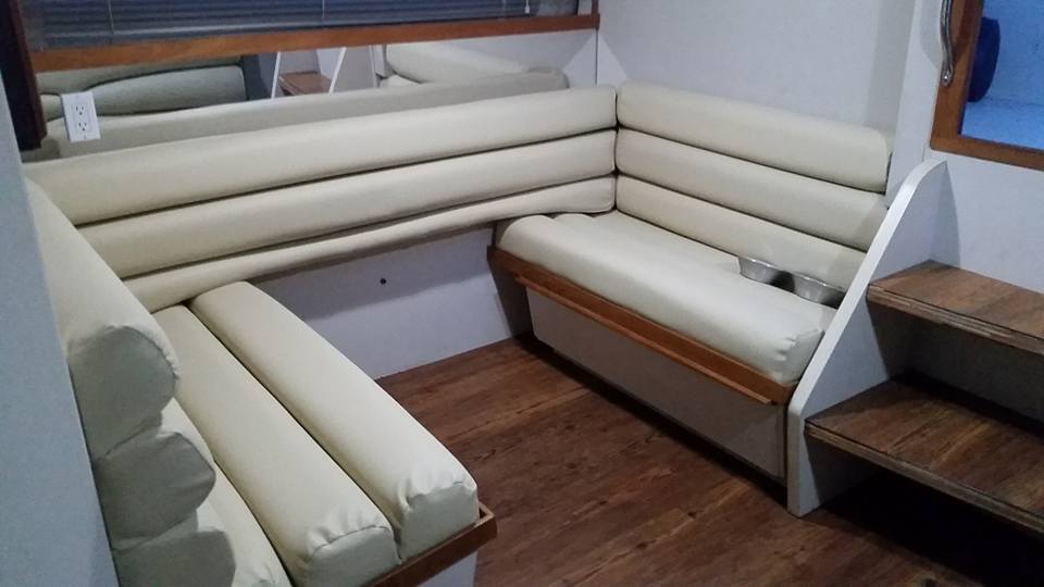

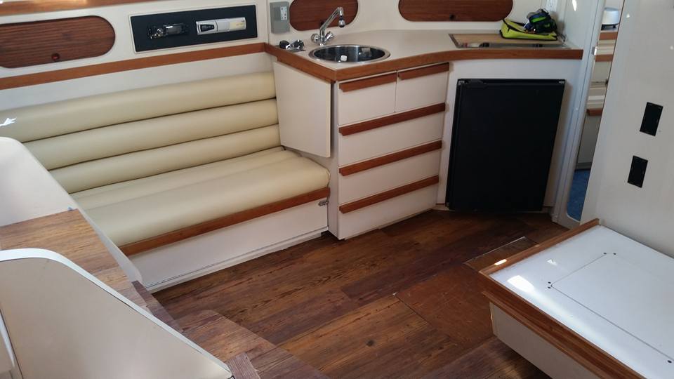

    There are screws in the cushion between the folds that go through the fabric and into the plywood. I just pulled all mine out, and my wife just reupholstered our couch and dining area.

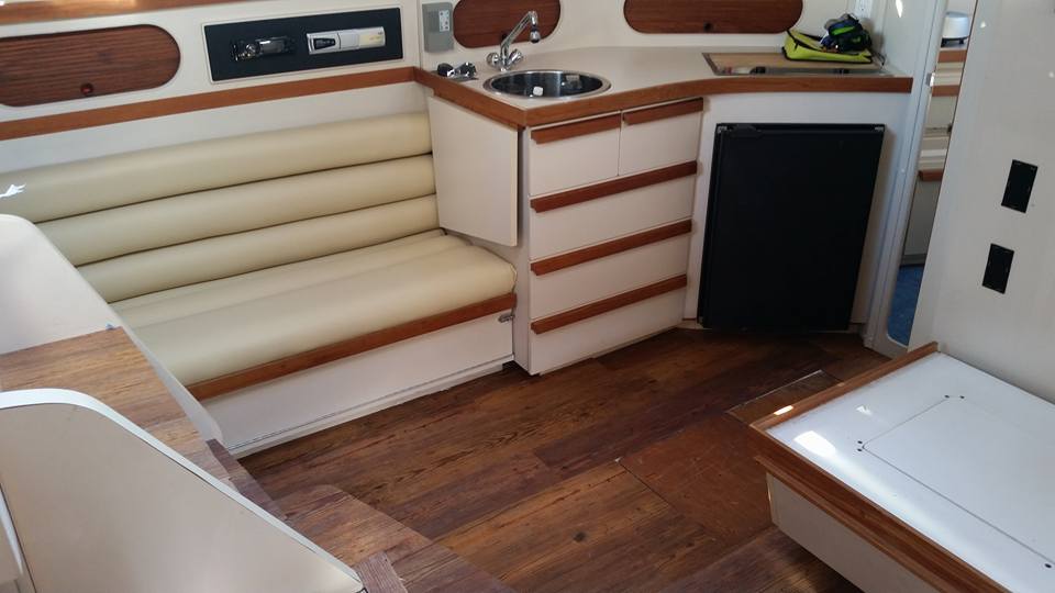

    That looks fabulous - love love the floor. I ripped out the carpet in mine on the main cabin floor and put a wood look linoleum down. I haven't figured out yet how to do that on the raised area that the dinette is on. Did you use hardwood or linoleum?

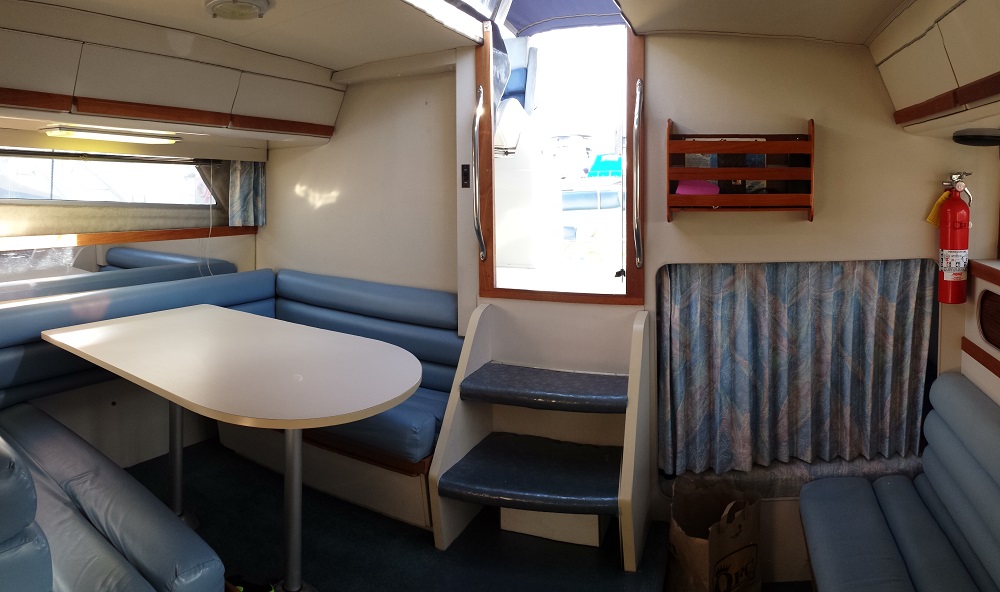

    We used a product that lays like hardwood but is a highly durable vinyl. I did the same through out. I just recently finished it but still need to do the trim on the stairs and upper floor area. I am so happy to get the dated blue vinyl and blue carpet out of there. This is a before and a link to the flooring I used. We have been enjoying remodeling her. http://www.urbanata.com/sustainable/flooring/luxvinyl.html

    The carpeting under the table comes up pretty easy, however you will need to remove the seat boxes. Lift out the cushions and you will see the screws. Remove these screws and the seat boxes lift right out, then you can pull the carpet up. The carpet also slides under the steps so its one piece. Fairly simple...The back cushion on the starboard wall is also screwed in in between the cushion folds you will find the screws. Run you finger across the fold and you will feel the screw head.
