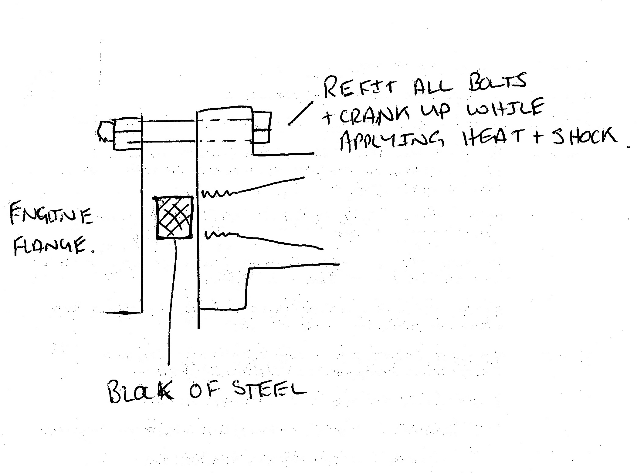

    View attachment 67754 Folks, I have been trying everything from hammers, chemical, flame and a 10 ton ram to separate by engine couplers from 2 1/2 inch tapered shaft. No luck. Any suggestions

    Try and set your up like in this rough sketch. I apologise for the lack of scale or neat drawing

    Couldn't delete my second post ( or didn't know how). Thanks K1W1. , exactly my plan except that I will put s steel plate on the engine side

    Steel plate and not use the tinsel of the flange? Nor the pre drilled holes, 8 (10) of them? Nor the space saving, it's already there? It may take all 8 (10) of the bolts to pop dat sucka.
    You may have a better idea with some plate, but I don't see it.
  7. Capt Ralph
    13,439
    Good sketch.

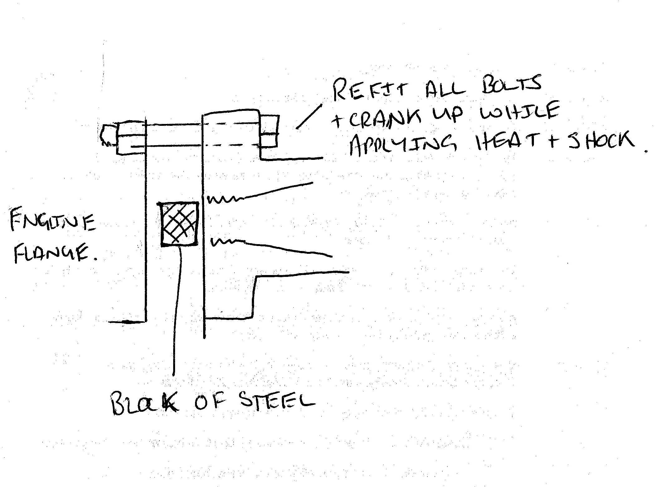

    Ralph's comment +2; but my neck cramped.
    Took the liberty of turning the sketch 90 degrees.
  9. K1W1
    7,427
    Get the lump of steel inbetween the shafts ends and crank up on the bolts - you will be amazed by the loading of a circular bolt arrangement on Hi tensile 3/4" bolts. Use hard washers under the head of nuts and bolts and lube them. Use a flogging spanner if you don't want to damage your showroom ones.

    I don't think the op's thinking it through. It's not going to put damaging pressure on the crankshaft, you're pulling against the coupling on the reduction gear. Pull it up tight and smack the coupling on the side; hold a backup on the opposite side of the coupling with a sledge. Easier with two people. Or pull it up tight and get after it with the heat.

    You guys are correct. I had the crank end and the gear end confused. Still, I am going to crank those bolts against a plate rather than the engine side flange or the gear itself
