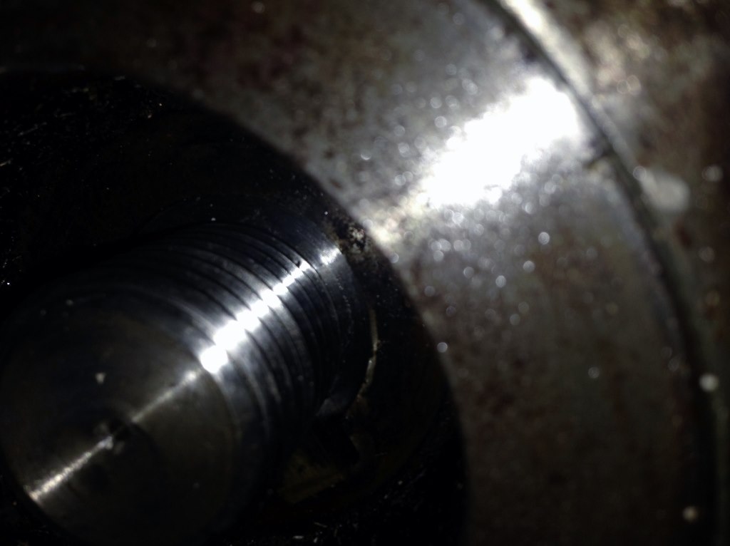

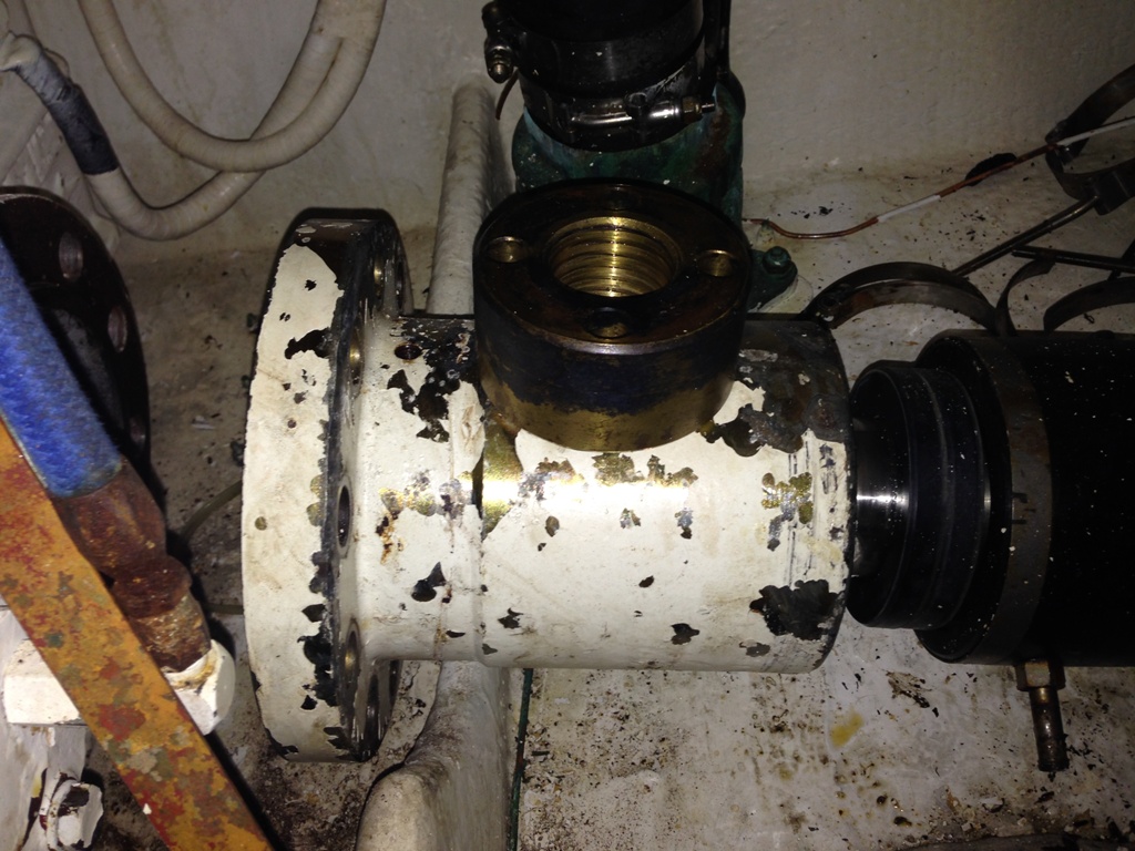

  16. Beau
    Beau Senior Member
    Jan 15, 2010
    2,261
    Beaufort, NC
    Hers the pic of inside the coupler... not second nut that we can find. Heated the other side that's why you don't see the "burn". Trying clicking on the photo. It gets clearer for me when I do that
  17. dsharp
    dsharp Senior Member
    Aug 23, 2009
    240
    lake jackson, tx
    Can you back the nut off a couple of turns and use the bolts to put a strain on the coupling . I've had the best luck putting a strain on the coupling then hit it on the side with a large drift. I kept a short piece of 1 1/2" shaft for a drift. I can't tell how large the bolt holes are, the bolts may be too small to get enough strain on it. If you use heat it's going to take a rosebud to get enough heat in that coupling.
