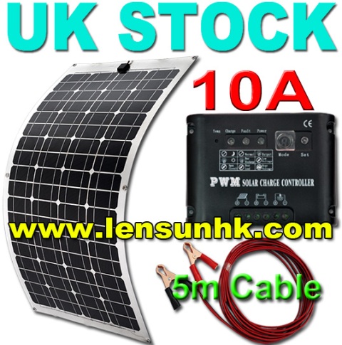

    That is really a no-brainer. One temporarily installed solar panel of 12 Volt, 100 Watt plus mobĂ­le solar charger will keep your batteries fully charged. If you really want to stay on the save side, take two panels. In northern Italy, their should be enough sunshine even in winter, to power your solar panel during daylight and get you more than 420 Amps per week (costs less than 400 $ including shipping).
    One quick search on the web:

    So, as you and HTM09 did suggest, the solution passes through installing a solar panel system. I personally hate those aestetically horrible hardware, but I've to admit that can be a good help.
    Just one point: the solar panels on the market in Italy, both monocrystal and double, seem to have a very less favourable ratio of power/price. Let's say that for that budget you don't get more than 24-30 watts installed.
    Thanks for the link. I'll take a serious look.

    At first, you are not really installing them. Those flexible panels are strapped onto the coach roof or hardtop of a powerboat or can be placed on the boom of a sailboat. When the boat is in use, you can stow them away. Those portable solar charger kits are very common in the yachting, outdoor and camping world and are not expensive any more. You are not expecting them to last 25 years like those panels on the roof of your house.

    Having said that, and hopefully not becoming the target for a lot of poisoned arrows ;) , I'm afraid that the solution to my question will not be in the ideally fair area. I mean that even a 100w solar panel (installed power in theoretical sunny summer conditions) would produce a very low power during long and frequent fog or rainy or cloudy winter days in many northern italy marinas (think to all northern Adriatic ones, to say the largest), thus not balancing the consumption of even few ampere/h. And the most frequent solution is to pay a workshop to periodically switch on your boat shore power connection, despite marina's rules... A very objectionable but practical way out.
