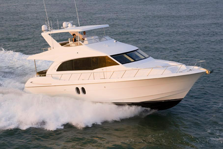

    Hey everyone,
    I'm looking to buy a motoryacht under 65' that's seaworthy and has a good range but that cruises at roughly 20 (or more) knots. I've been looking at the hatteras 60', but the general lines of the boat appear ugly to me especially if you look at a picture of the boat cruising (i miss some of the older models). Also, the transom looks like a design that came from a cheaper boat (i think someone on another forum said it looked like the marquis). Perhaps one of the viking sports cruisers would be a good boat, I haven't heard much about their seawothyness though. Any other suggestions?
